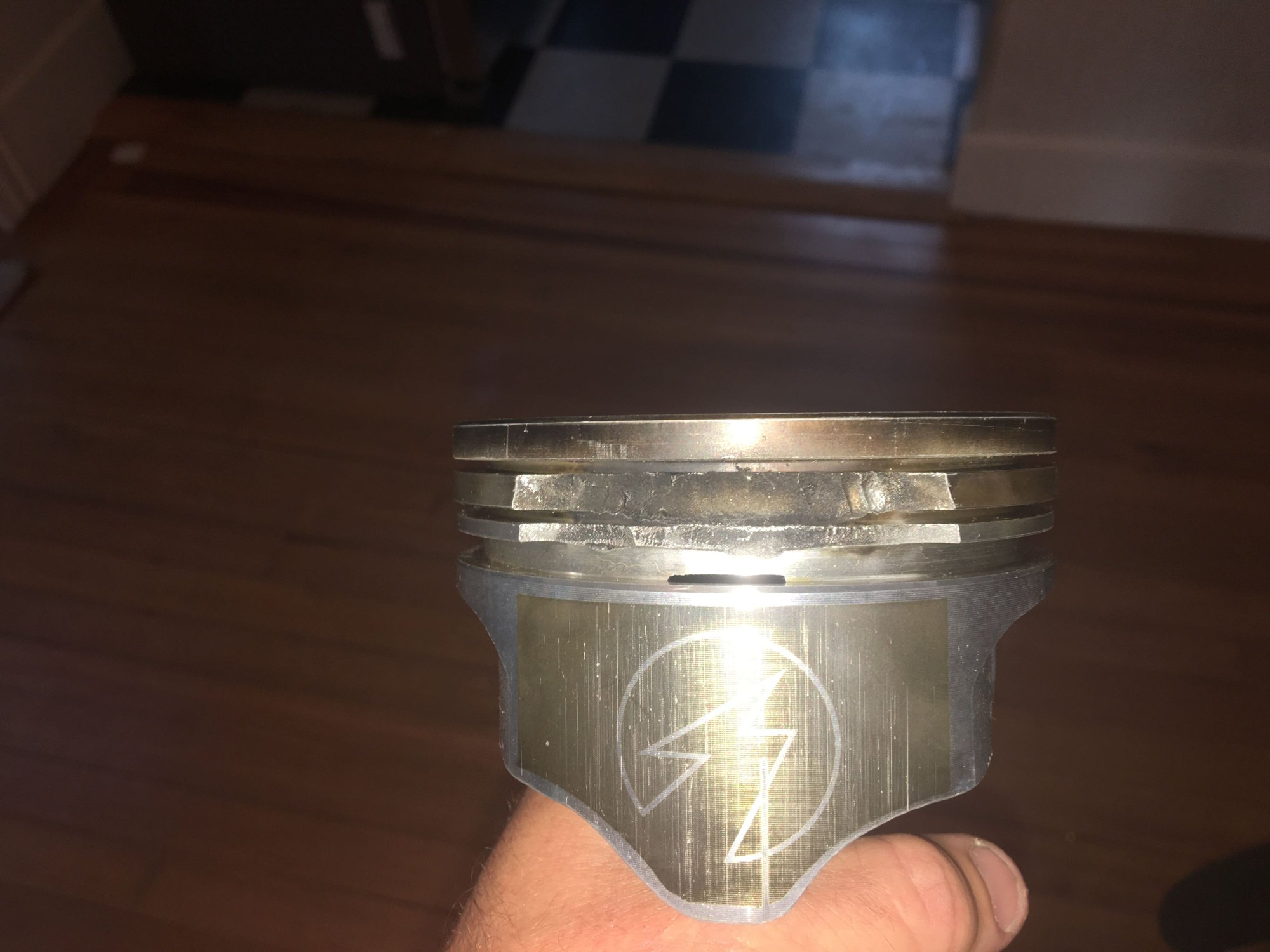

Piston is at the machine shop. Engine guy said definitely detonation.
Whats the the chance the other Pistons have damage? I did not take them out to inspect and I really do not want to.
Thoughts???

With you compression test most likely not. The other 7 were high so I would try it. If compression was low or "all over the place" I would pull other pistons. You do want to make sure ESC ( knock sensor) is working.

So what i ended up doing was pulling all other 7 pistons and bringing them to the machine shop. I have a new set of pistons and rings on order.
It would have taken me a few hours to remove rings, inspect pistons, buy new rings, reinstall them, etc. While im this far down, I'm just taking every precaution necessary. I need to remember how lucky i am that all the block needs is a quick hone.
250 bucks for pistons and rings plus their labor is so worth me not doing this again. The car is going back to the dyno tuner once it's running.
When i did the compression test, it was my first time doing it on a sbc. I vaguely remember one other cylinder taking its sweet time to hit 180 then 210. This route covers my *** and also takes out that uncertainty in the back of my mind every time i punch it that another piston or 7 MIGHT be ready to break.
I'll have him check knock counts when its on his scanner.
Thanks all...I'll keep you posted.

Was there anything that could have caused a hot spot that would have only caused detonation on that one cylinder?

Engine is at the machine shop. Engine broke on the dyno. Same cylinder 4 ringland failure. Cam bearings, Crank bearings were shot. Ended up figuring out compression ratio was 11.4:1. Cam was indeed 4* advanced and never degreed in.
I have another thread regarding the old unknown cam. Needed new cam and lifters. Bought new rods. Will need new pistons. Add in flywheel, clutch, and PP, as well as some trans upgrades for the zf6, I'm well over 3k. Sucks to suck but i need to get it right this time.

Cyl.4 again? Something strange here! Tapered bore?

The problem is detonation too much heat, too much timing, not enough fuel, too high a compression ratio. On SBC typically cylinders #3 and #4 are the first to detonate, the coolant flow around those cylinders seems to be the worst and they will detonate before the others do. When you run a engine with 11.4 compression and the 219 cam with a superram you need to have good fuel, correct timing, correct AFR, and cool water temps near 160 degrees. If any of these are off the engine can detonate and damage like his pictures show is the result.
I agree with all. 210 psi is too much for street motor (what is lobe sep angle) 11.4:1 will not play nice with pump gas. look at a crate motor from a good builder, and do your own tuning.
