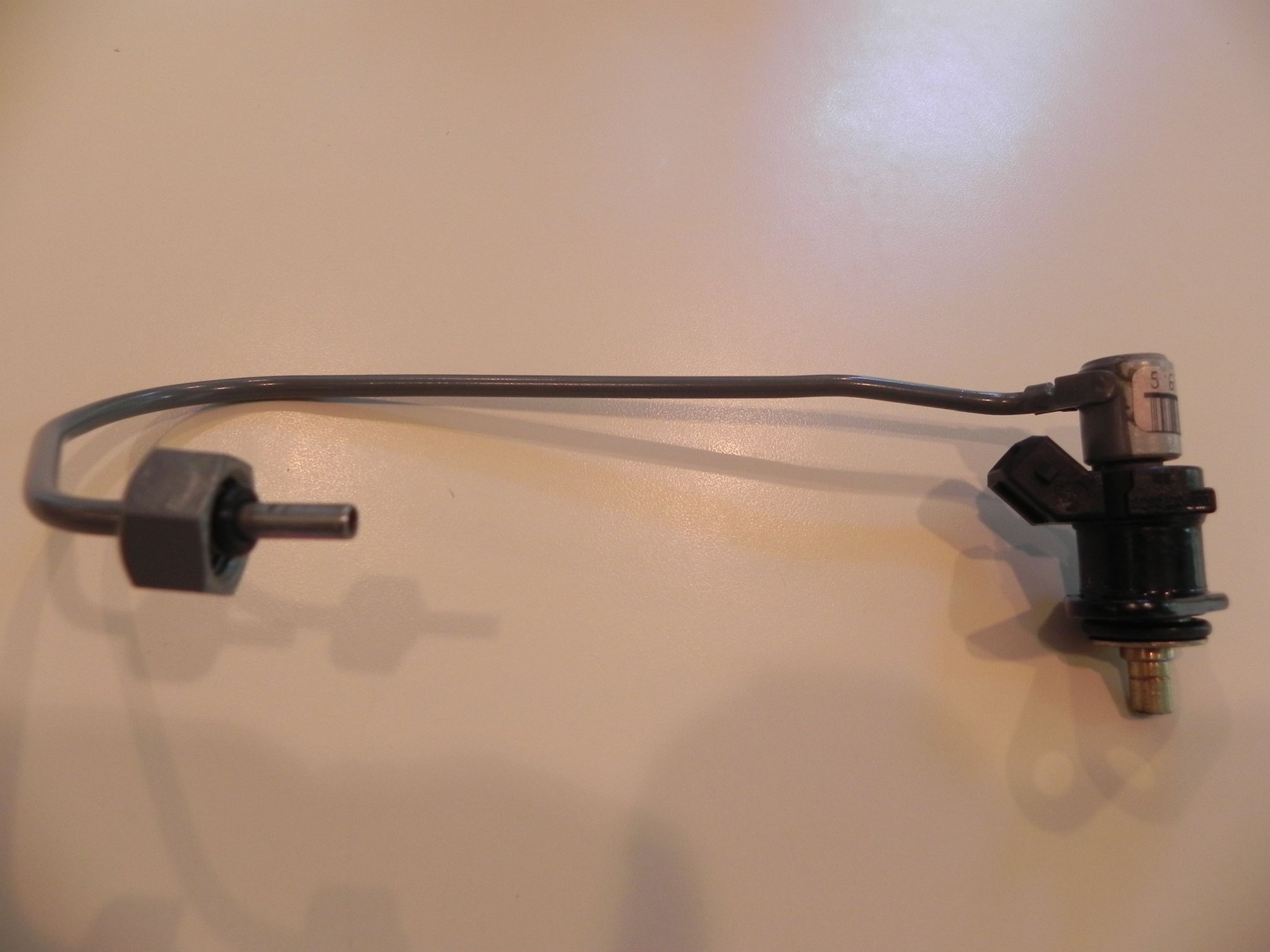

It has a funky mounting arrangement:

Give Jon a call. Maybe he can walk you through removing the pipe for easier shipping or maybe not. I never had one so not sure but they can clean and test them for you.
Alternatively, you can seal it up and change your programming to spray more fuel, so I have been told.
