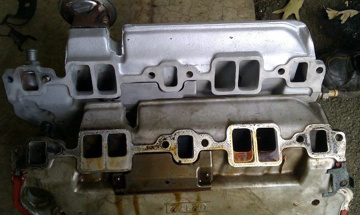

If you're on a budget, the only thing you really need is to open up the ports on that CFI intake manifold! That's a MUST! Just like Tom said!
Keeping the CFI will save you all that potential conversion money! You've already got all the right stuff!

Stock CFI intake next to ported.
To Any CFI to Carb Threads ?
