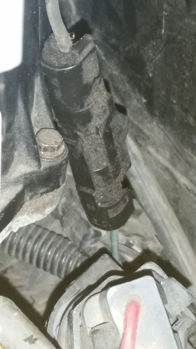

Ok, so wiring is good at the pump and upon further inspection.. The fuel pressure drops even quicker after driving the car a bit... But once hot itll drop sitting in neutral while revving on it... gonna ohm put the 9th injector just incase.. but its coming along...
Also I found this, behind the distributor.. Its a green wire, then the connector.. Then its black.. Where does the black wire go? It's just a frayed wire that had electric tape on it now.
