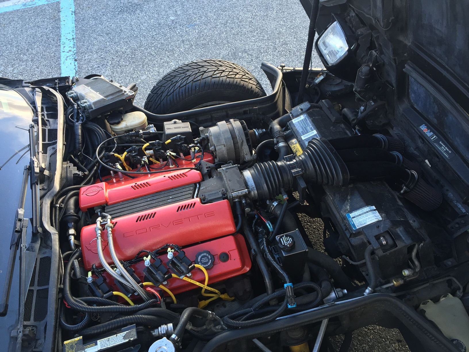

Old Aug 30, 2016 | 08:47 PM
94VenomVette's Avatar
94VenomVette
Joined: Sep 2015
Posts: 382
Likes: 17
how i had my coils mounted, but when I'm done with my solid roller 383, will look a bit different
