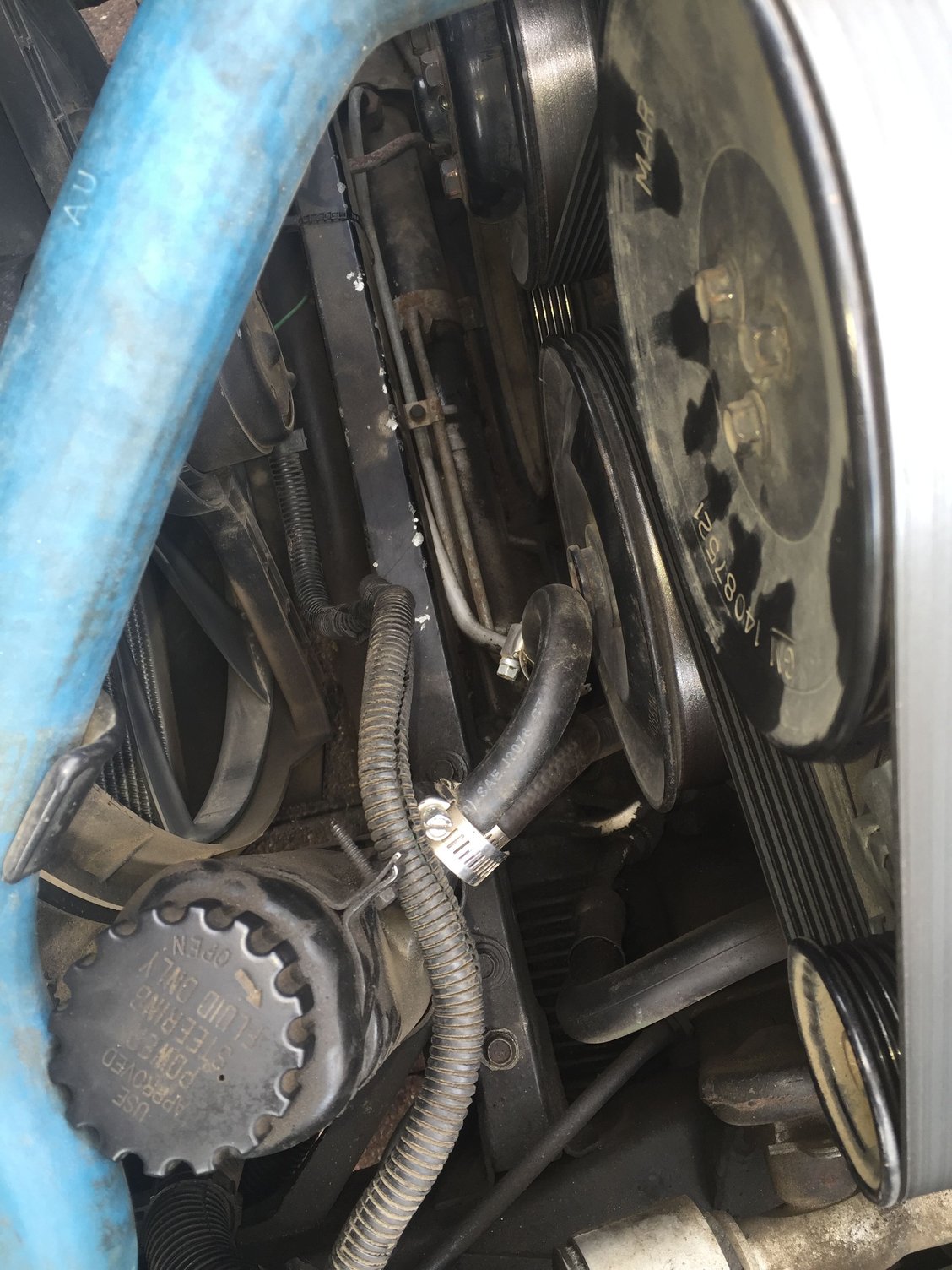

I have this pic I will take some Mor tomorrow

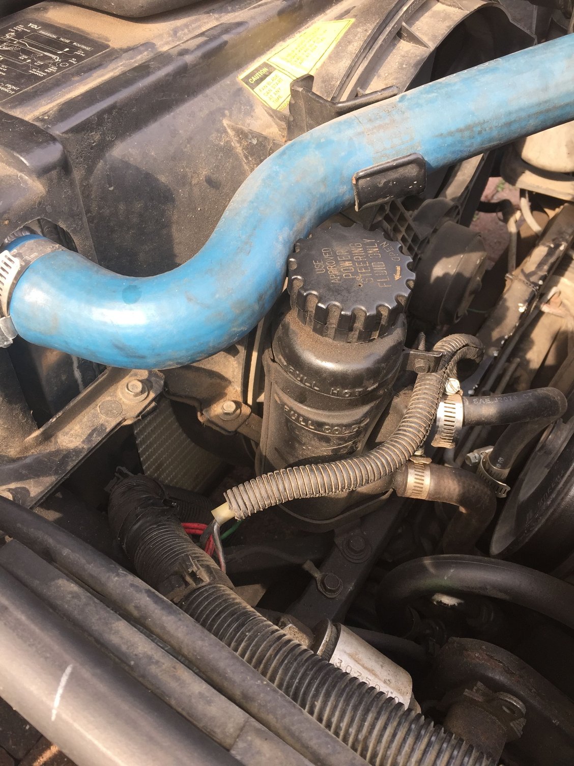

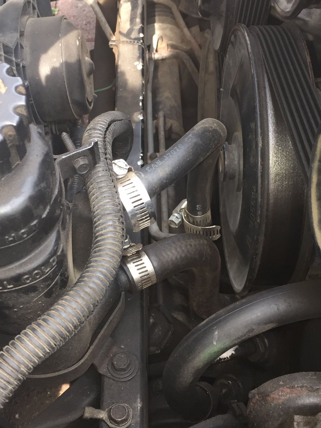

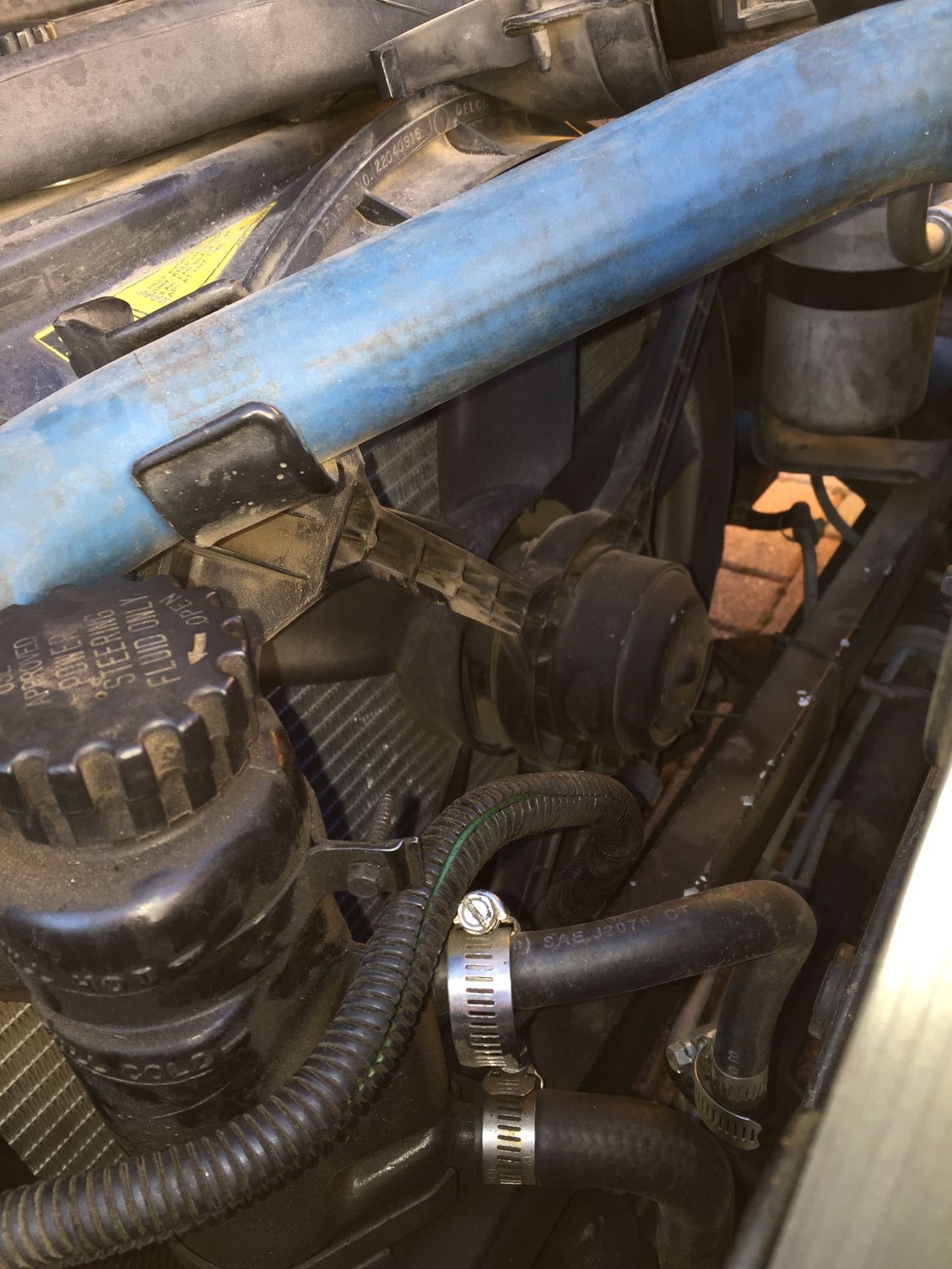

Here are some pics I took today

Thank you,thats a big help. I've got the same bracket. looks like it mounts to the crossmember and radiator shroud. The only difference I see is the bracket hole for the shroud on mine sits about an inch below. I should be able to come up with a spacer
