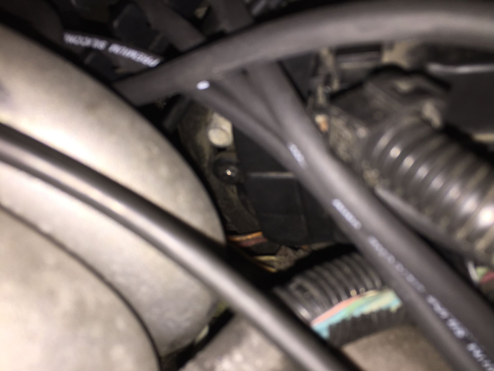

I found this guy sitting on top of the wiper motor, it goes down the side of the wiper motor, I can't seem to see any more of where it goes after that. Looking at the VAC diagram is not showing me much as far as what it is.

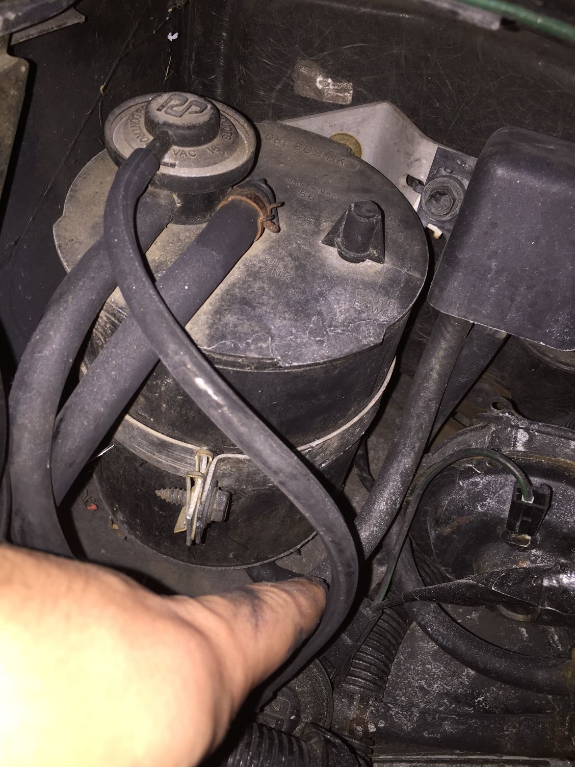

I also found this guy, this one goes to the charcoal canister, it connects with another vac line in a Y. It looks like this might go to the throttle body?

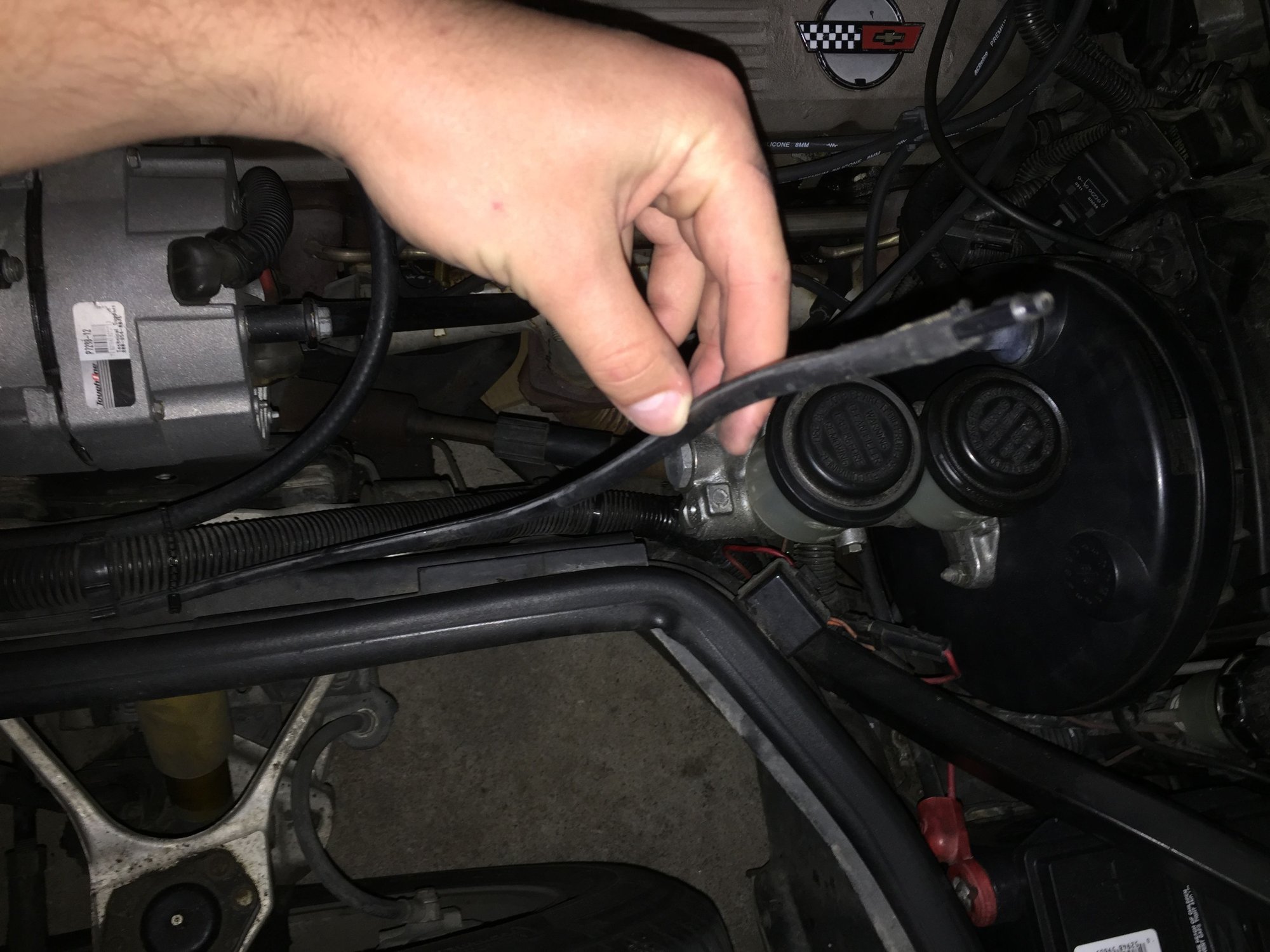

Tracing this one it connects to the top of the charcoal canister.

top pic looks like a vent hose. I'm having about the same problem on my 85. had a 33 code replaced maf tps and computer still have a intermittent 33 today it idles up and down.
Vent hose for what? And wouldn't it be shown in the vacuum diagram?

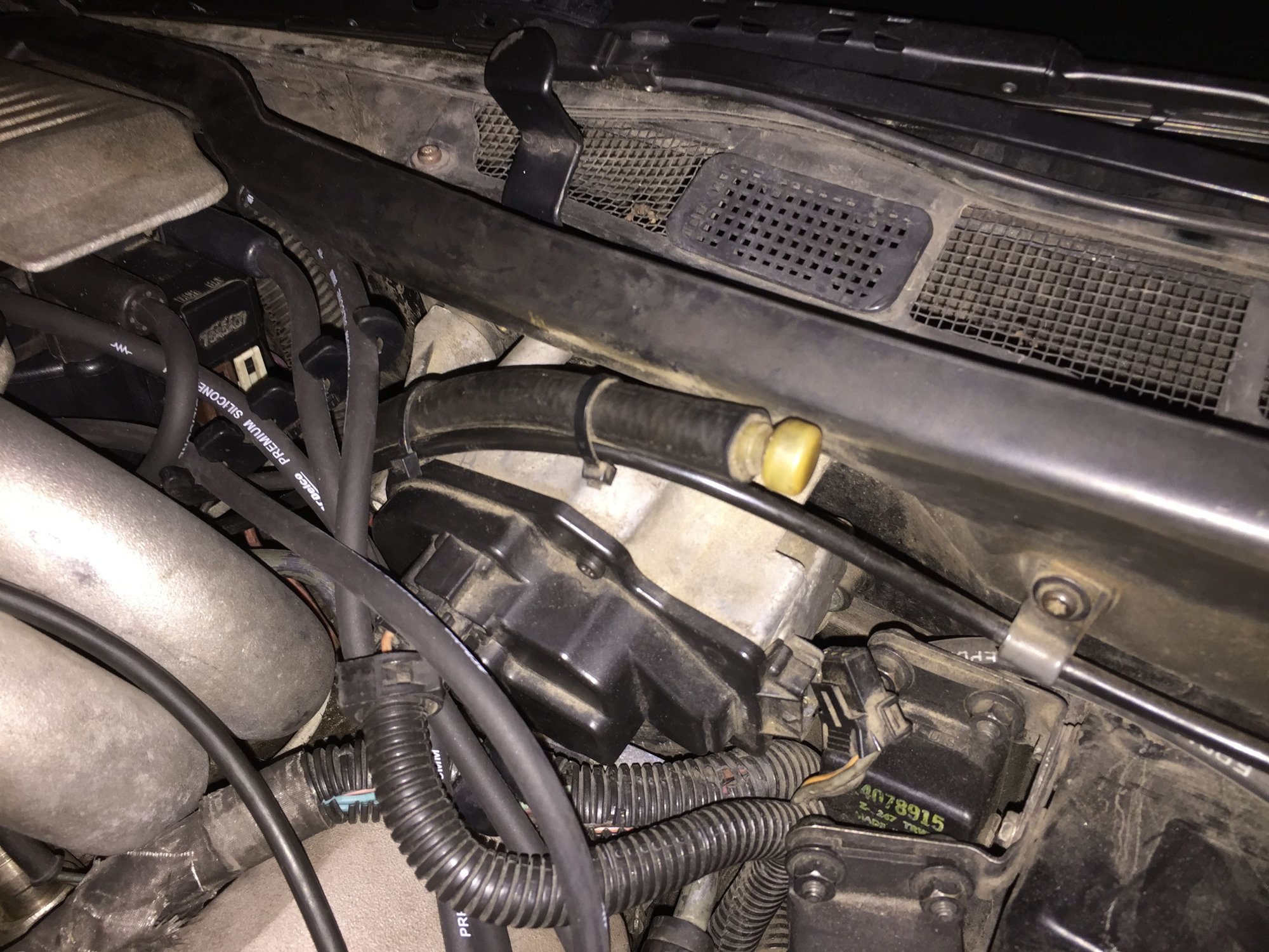

Ok, I figured out what the smaller hose is, it appears that it is the line from the charcoal canister that goes to the TB, under the TB was a nipple that was capped off. Based on the diagram I'm assuming both the EGR and Charcoal canister went into this nipple with a little T adapter of some sorts and the previous owner just capped it off.
looks like transmission vent hose
Ok, I figured out what the smaller hose is, it appears that it is the line from the charcoal canister that goes to the TB, under the TB was a nipple that was capped off. Based on the diagram I'm assuming both the EGR and Charcoal canister went into this nipple with a little T adapter of some sorts and the previous owner just capped it off. i had a friend in the front seat watching the rpms rather than nust relying on hearing.
but first, do you have the mi imum idle set right? google this procedure and set it for about 520.
if yu do it and stil cant idle steady, start looking for van leaks.
hi there. i have an 85 and just totally overhauled it right down to the bead gaskets over last winter. i might be able to help.
the nipple under the throttle body supplied vacuum power to the egr sole noid and to the vacum cannister solinoid.
that said, the main vacuum line that does the sucking of the fumes in the cannister is actually tied i to the steel tube that runs along the driver side valve cover, picks up the pc. valve, and goes into the intake niple
there is a small piece of hose that bridges between the intake vacuum port and the egr/cannister tube. my bridge hose was very old and stiff and there was no seal. huge vacuum leak. if i sprayed brake clean around the area i could hear the vauum power around that old hose schucking it up intothe intake and it would speed up the rpm.
there are numerous places that a vac leaking could be sucking in unmetered air. ive never had luck shooting propane in around the. e gine but a bottle of carb cleaner does the trick nice.
you will hear the car rev up slightly flamible fumes are sucked in and burned in the cylinder.
pull the flr vac line off and see if its got fuel smell on it.
