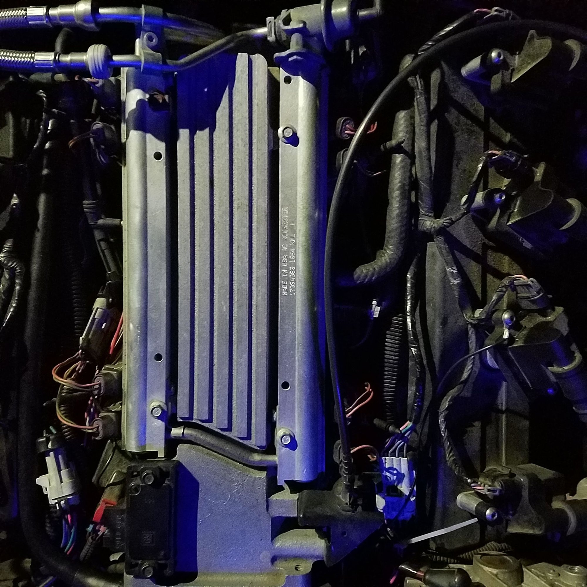

Hey guys I installed tfs heads and edelbrock intake on my 1993 LT-1 vette . My stock fuel rails do not fit the edelbrock intake. I called edelbrock and they said my rails must have been altered . Does anyone have the gm part numbers for the two vette rails . Any other info would be great. I want to show edelbrock there are different fuel rails.

92 - 93 rails do NOT have a front crossover tube
94 - 96 have a front cross over tube
