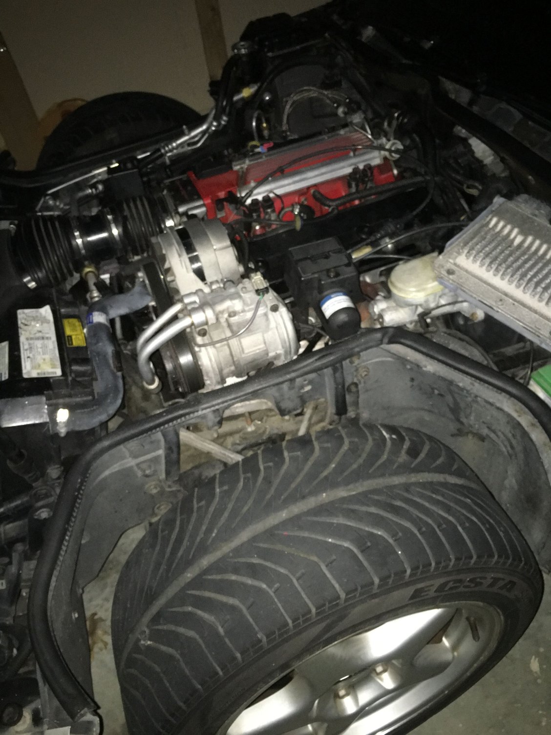

History of the car is that it has been sitting for a while. I am going to guess almost 2 years just from looking at the receipts for work done.
Work done.

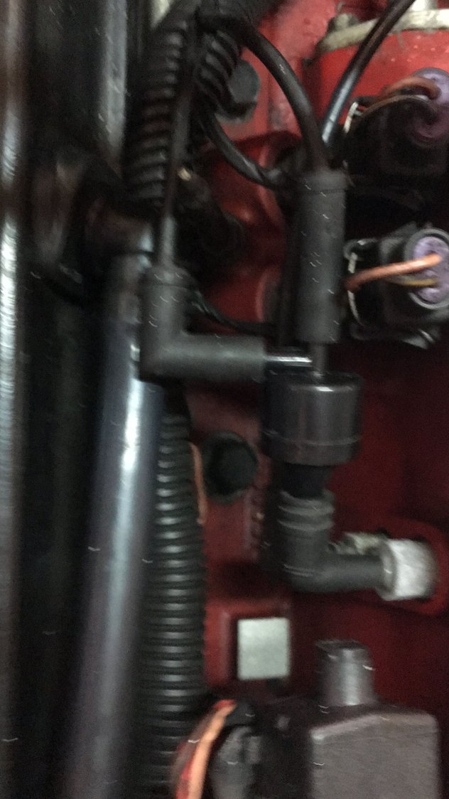

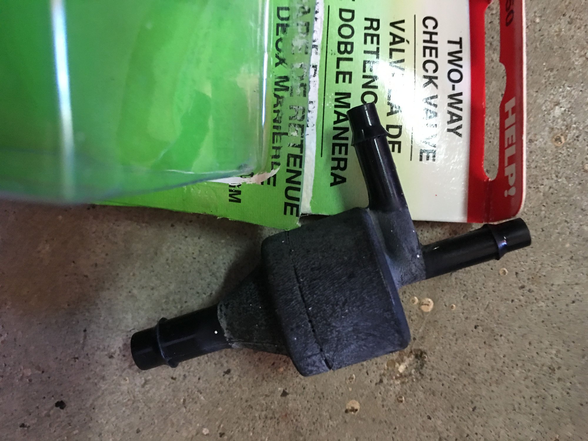

The opti was supposedly changed a year ago, but I see that the opti vent hose is not hooked up. Plug wires look newer. I need to pull plugs to see how they look.
I was told gas was old. Fuel tank is almost empty.
Plan is to siphon out gas to inspect and pressure test fuel system at shrader valve.
Jack up car and inspect 02 sensor connections, and knock sensors.
Check ICM, do Optispark testing and hope for the best.
She idles a little rough and I need to fix these items to get inspected.
The other thing is I am going to rebuild the steering column since the tilt is broken and may be causing ignition switch to malfunction. Car sometimes has a hard time turning off when key is turned to off position. When I readjust tilt it works.
Washed car last night and can tell it going to need a clay job and good polish and wax!
Any tips/advice are greatly welcomed. I followed Chstitan42 s post on his 96 LT4 and I am hoping it is not the opti but hey you never know.

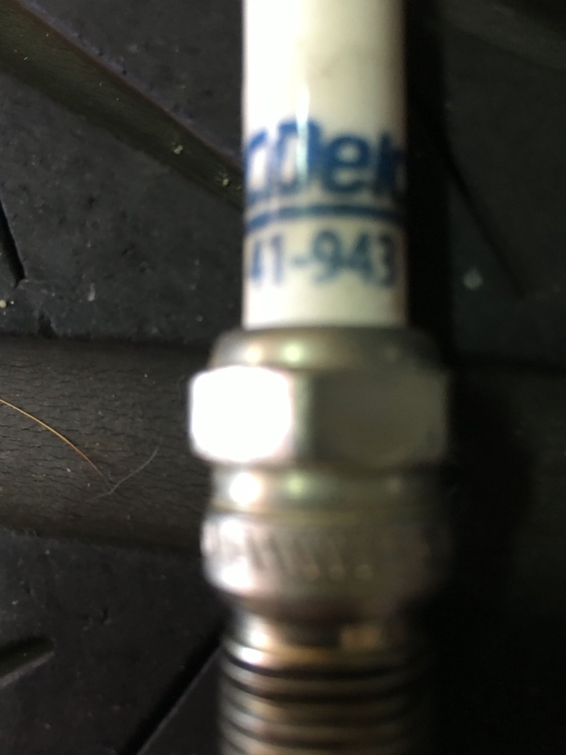

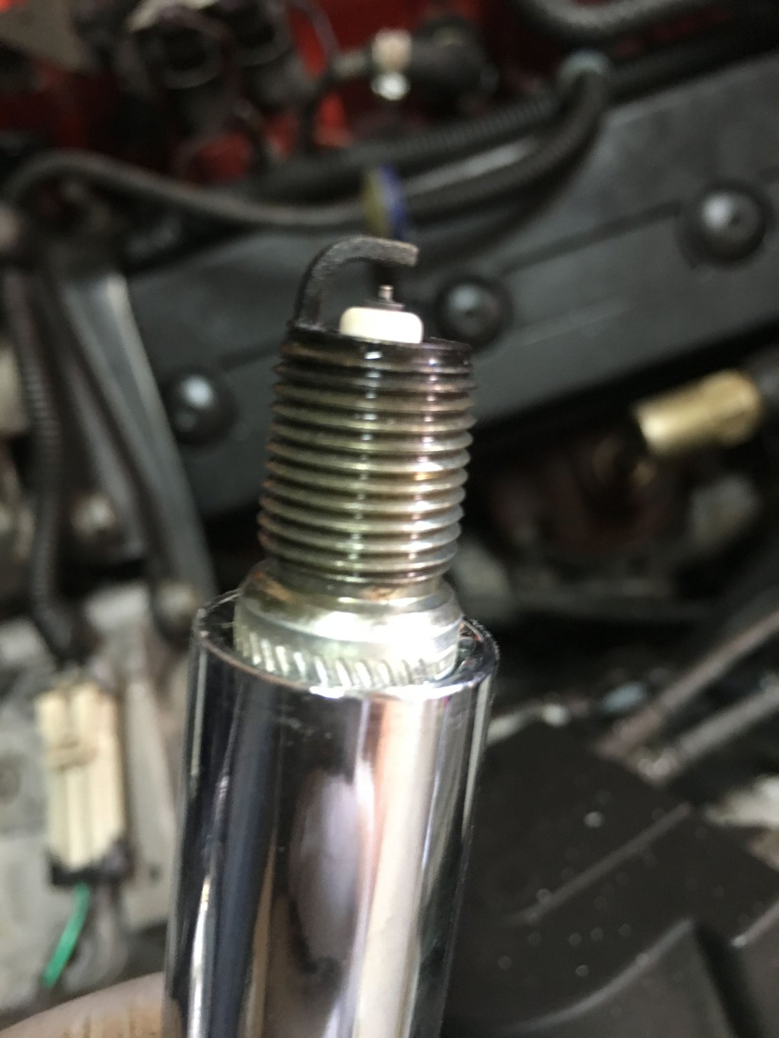

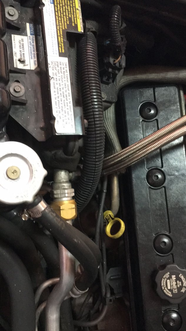

I had a break today about an hour so I took off the spark plug near the oil dipstick and it looked new. I checked the spark plug wires were snug on the passenger side. I also checked vacuum hoses and changed the check valve on the intake manifold fuel rail area. It just looked old. I cleared the codes with the Torque App added some Lucas Fuel Treatment and ran it for 15 minutes seemed to idle much smoother and now misfire heard. No Check engine light either! I know it may be too early to tell. I need to run it on the road! My thinking is if it is fixed (no more codes) I might be able to tell the guys at the inspection station to NOT move the tilt steering wheel and if it holds firm maybe I can pass inspection!
Wish me luck.
Just took it for a spin and p0300 code came back. I reset it then drove again just around the block and it did not come back. I am almost out of gas so I think I am going to call it a day and then try tomorrow or later this weekend. I need to fix that steering wheel it still comes down and I don't think it will pass inspection.

Thanks! Kg4fju! I think this maybe the issue. I looked at the lower Timing Cover I think that is what it is called and I can see the Crank Positioning sensor wire/connector. I am going to pull the intake and some hoses to get down there and check it out. I might have to also jack up engine a few inches per others that have had to check this. I hope I don't have to but they say there is only 4 motor mount bolts and that you really don't have to take the bolts completely off just loosen them to lift engine 1/2 inch or so. Hope to get to this Saturday or SUnday!
I replaced my car's CPS the Winter before last and it was not that big of a deal. I didn't have to jack the motor up at all. It is tight getting in there but it is doable. The wire and connector are easier to get to from up top IIRC. However, I was doing the water pump, radiator and plug wires at the same time so a lot of the interference items were already out of the way and I could clearly see and get to the items I was working with.
I would definitely verify the sensor's wire routing as I believe you said the OPTISPARK was replaced on your car.

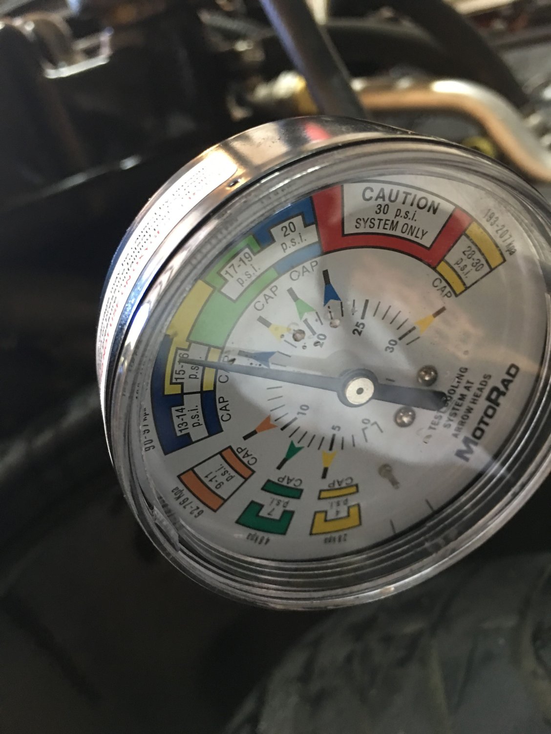

I did have a O Sh@$t moment when I did a pressure test on the cooling system. At 16 psi I saw coolant leaking but I was lucky it was loose hose clamps. I tightened them and no more leaks after pressure test.
I asked my wife who knows how to drive cars fast to listen to the vette while I revved it to at least 4k rpm and then also hold it stead at 2k rpm. She said, "sounds smooth and I don't hear any misfires." No smoke, nada or weird sulfur smells. I think there is a vacuum leak and that I need to track down. I read another LT4 forum where some one crossed two spark plug wires I think 6 and 8 and that caused a p0303 but his car was running ROUGH and mine is not.
The diagnostics continues. I really want to take this out on the highway and just BLOW all this crap out and hopefully that will help!
