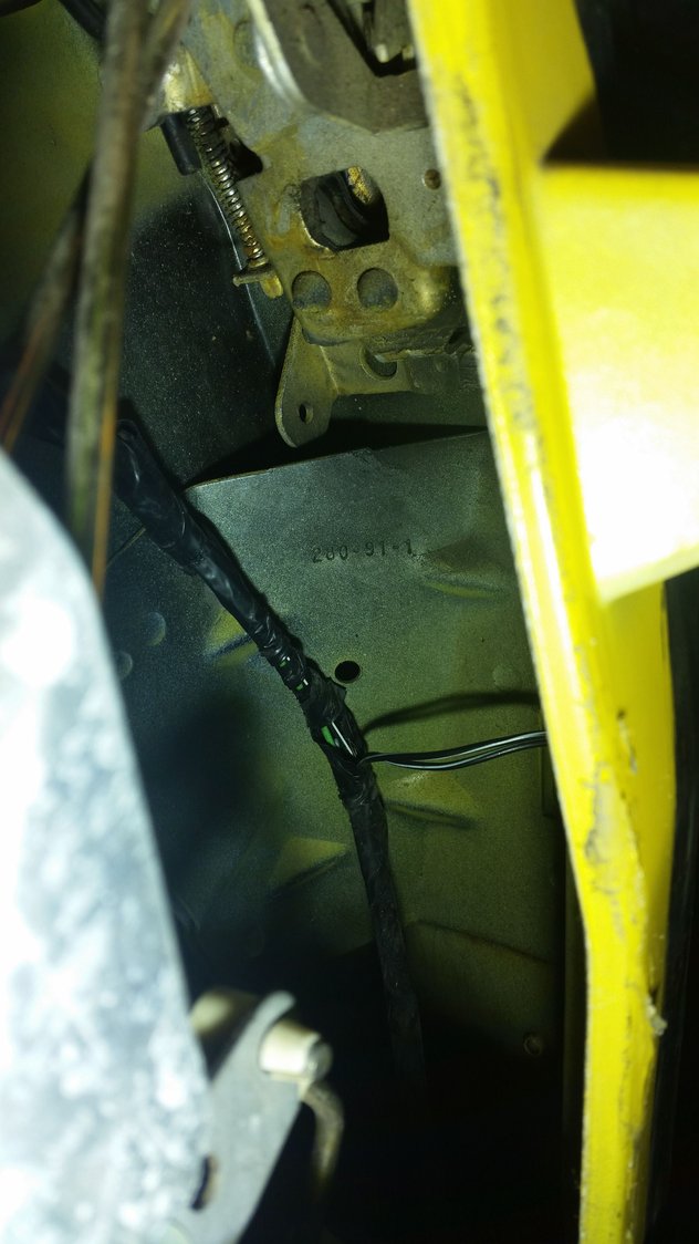

There should have been, but I think when my car was assembled the connector was routed behind the other wiring. The wiring is held in 2 places above and below the connector. I don't have a before picture, but I had to bend the wiring to pull the connector from behind the wiring bundle to get the length I should have had in the first place. That mystery is solved.
Door ajar switch wiring.
