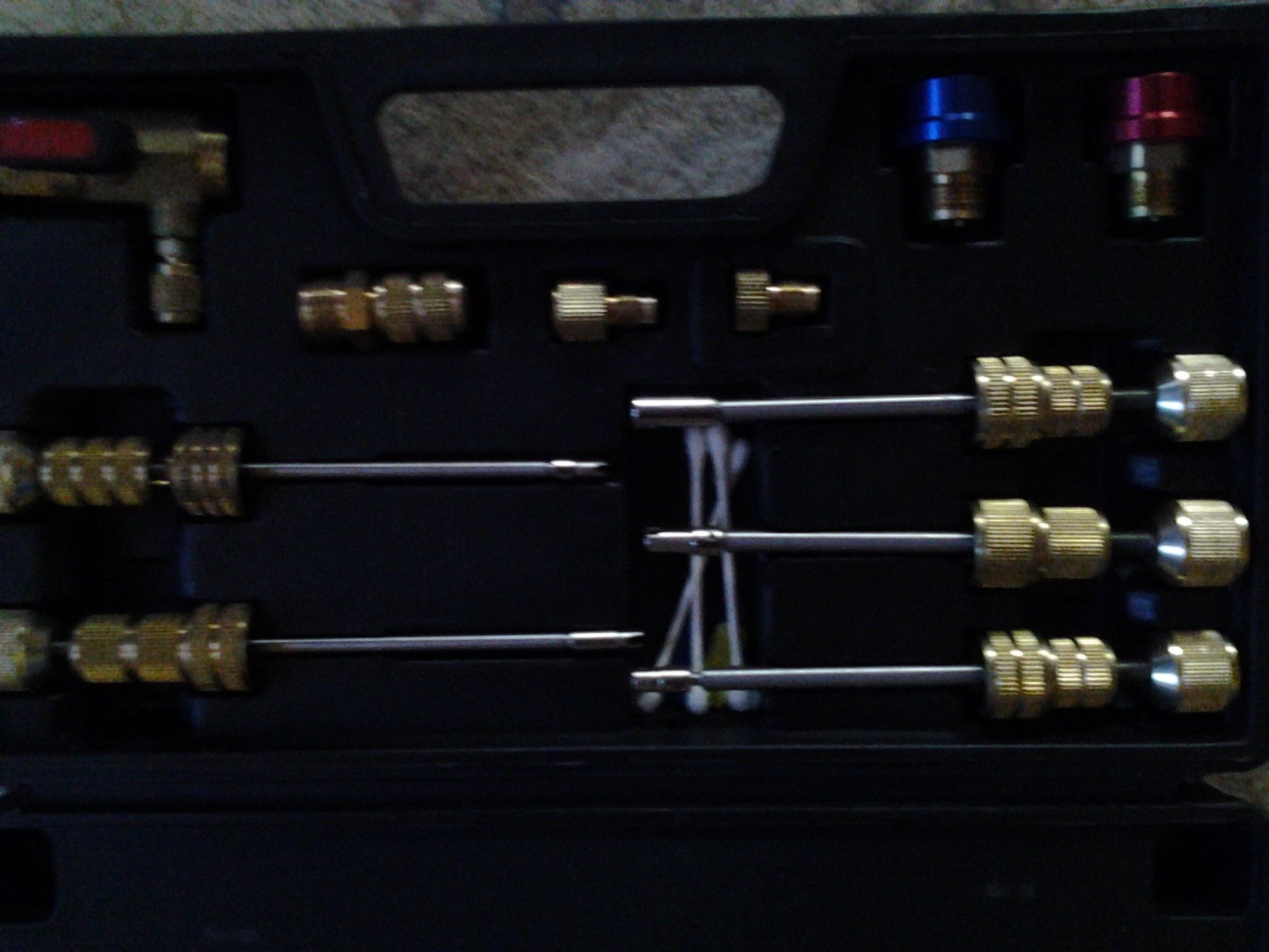

If you know a A/C guy he can change the valve without loosening the freon or you can buy the tool and do it yourself or buy a good new cap.

Here is my set I can change any Schrader valve.

It just needed to be tightened. One can of freon and I was good to go.
