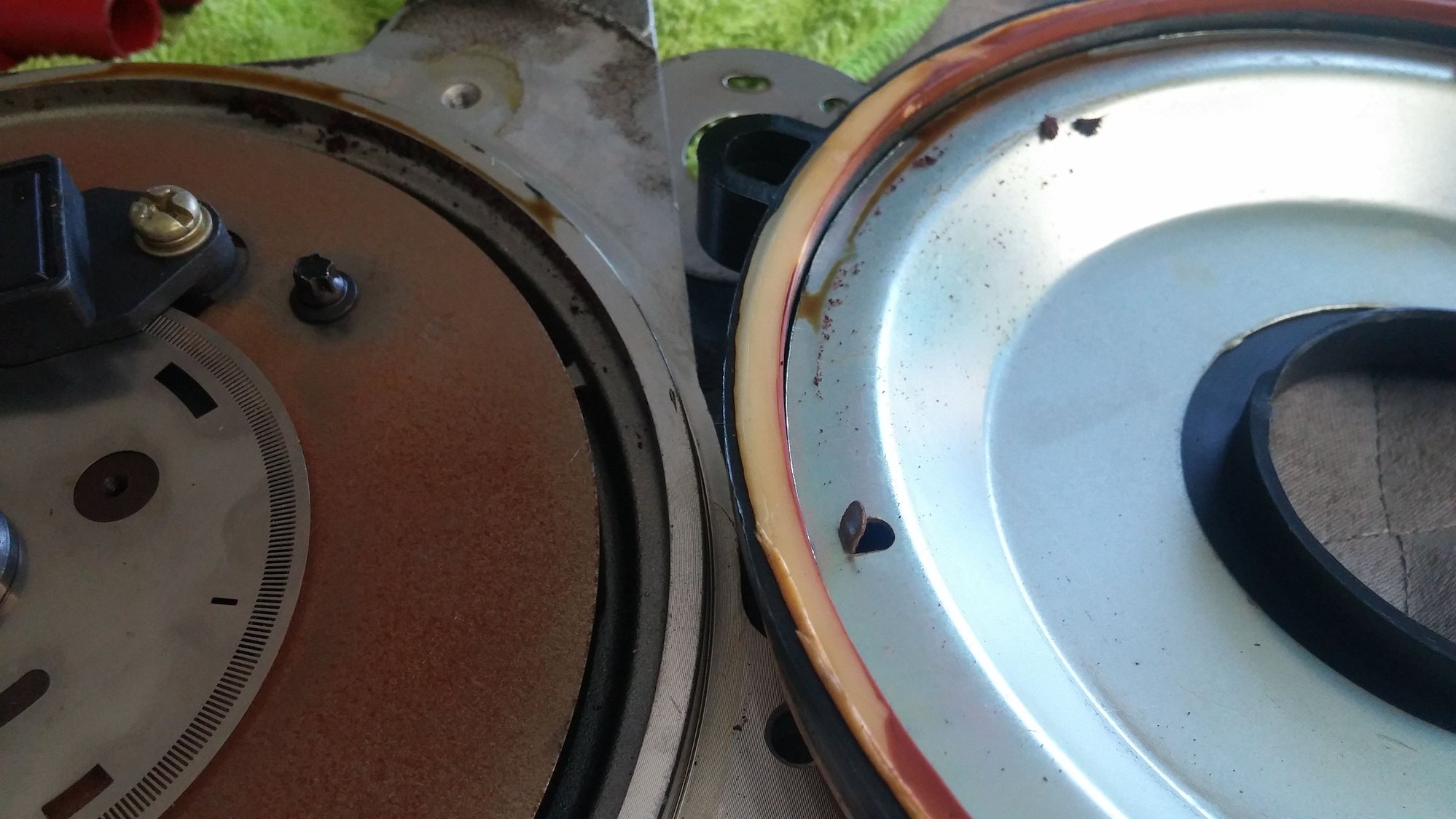

Got it out a little while ago. Cap and rotor do have carbon on them, but not much. Only thing I did find was the wheel with slots. If you see, in one pic it rubs against the sensor.

I thought I read that some optis were the wrong size (maybe pre vent or post vent) and the Waterpump or some other thing in front of the opti applied just enough pressure to the opti case to make it not function correctly. Hope you get yours worked out.

When you guys say to RTV the opti, what exactly do you guys mean? Like, where do I put the RTV? Sorry if it's a dumb question. I did not see much, if any oil on my timing cover. So I guess it's safe for me to replace any gaskets near there?

The original optis will have differant spline and can not be swaped with out major work.

It has a seal the needs to be replaced on the engine cover cheap and easy, The ATV is sealant that you will put on the cap to seal better be sure to locktight the cap and the rotor when sealing.

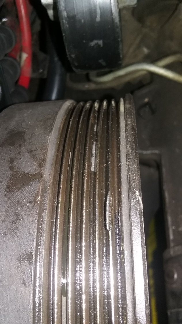

I noticed this while tightening the harmonic balancer. Do I need a new one?

Looks like it would chew the belt up,try to file the chip off of that rib mayby.
