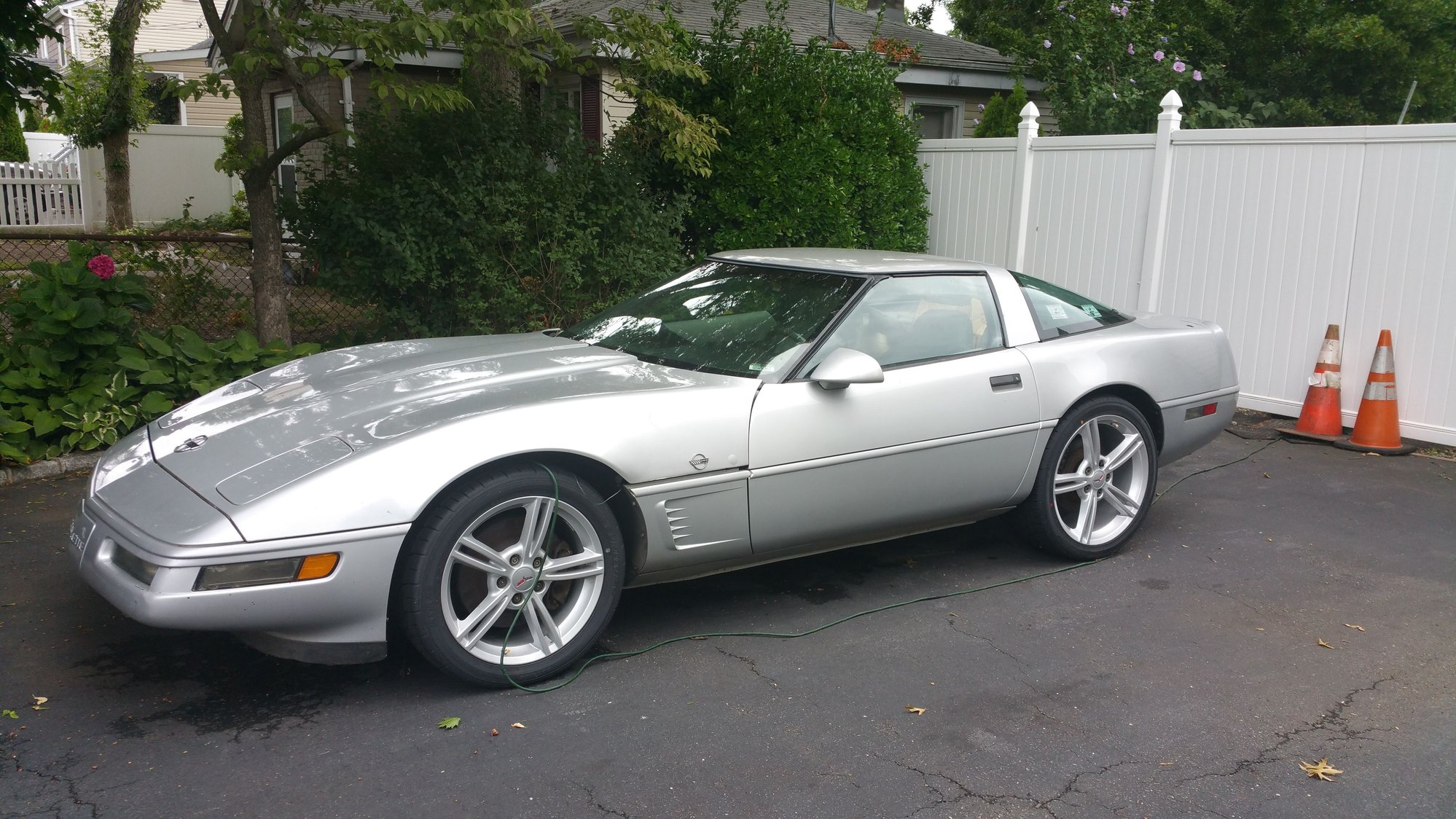

As an update, while I didn't really understand the wheel calculator, I measured the inside if the wheel to the edge of the rim and the original 17 x 9.5 rim measured 7 1/2 inches and the new 19 x 10 rim measured 8 1/2 inches. I used a 1 inch spacer and the wheels fit exactly as the originals. Contrary to some posts, the wheels would fit without spacers however were inset to the point it was within 1/8" from the brake line and would most likely hit on the first bump, plus the tire was very inset.

The car was just off of the jack so the rear wheel gap had not settled and looks higher but settled fine.

Originally Posted by Lt4-396
I have c6 wheels with no spacers or anything and it looks great, if you want any specific pictures just let me know.
That looks awesome
