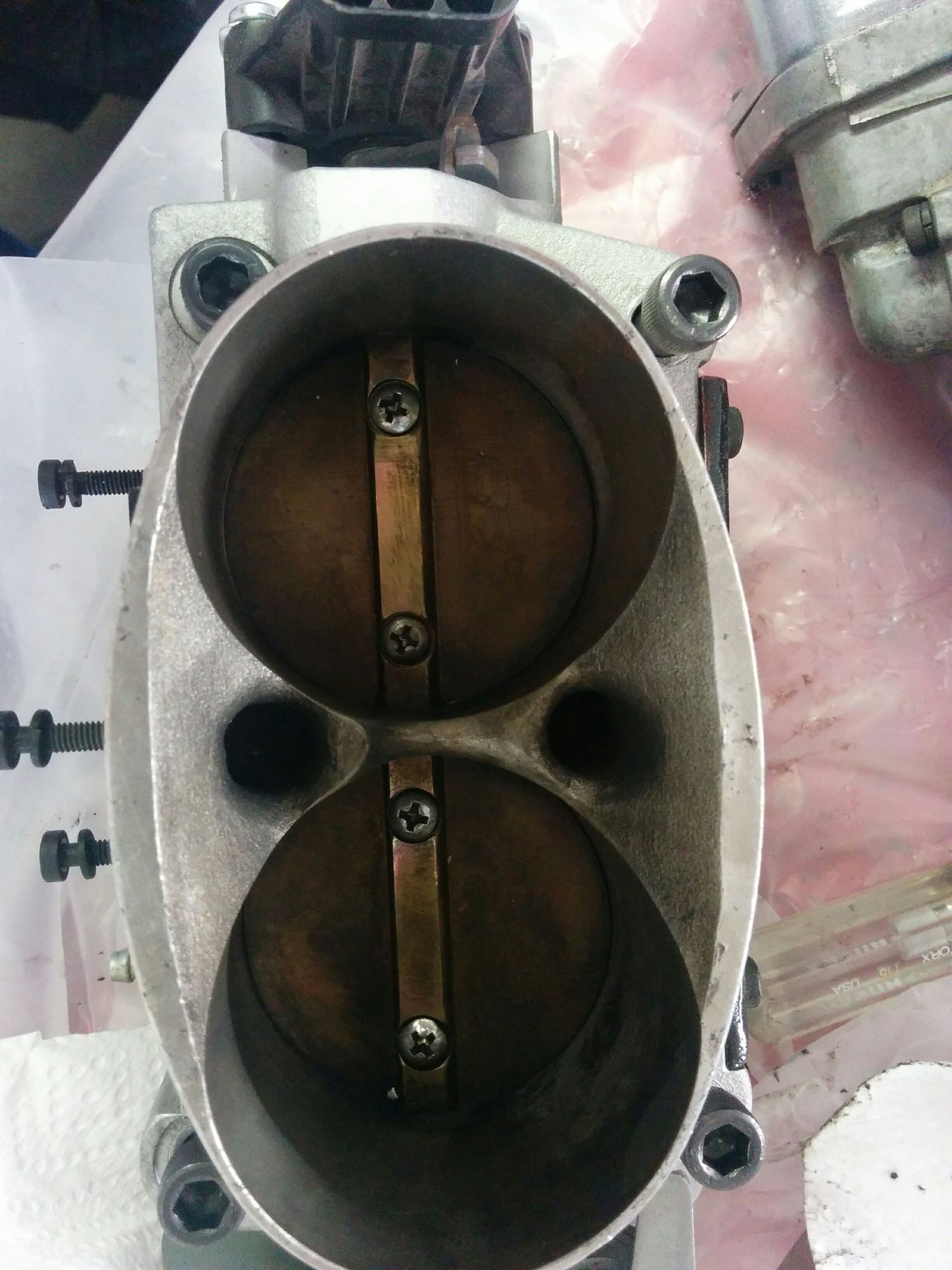

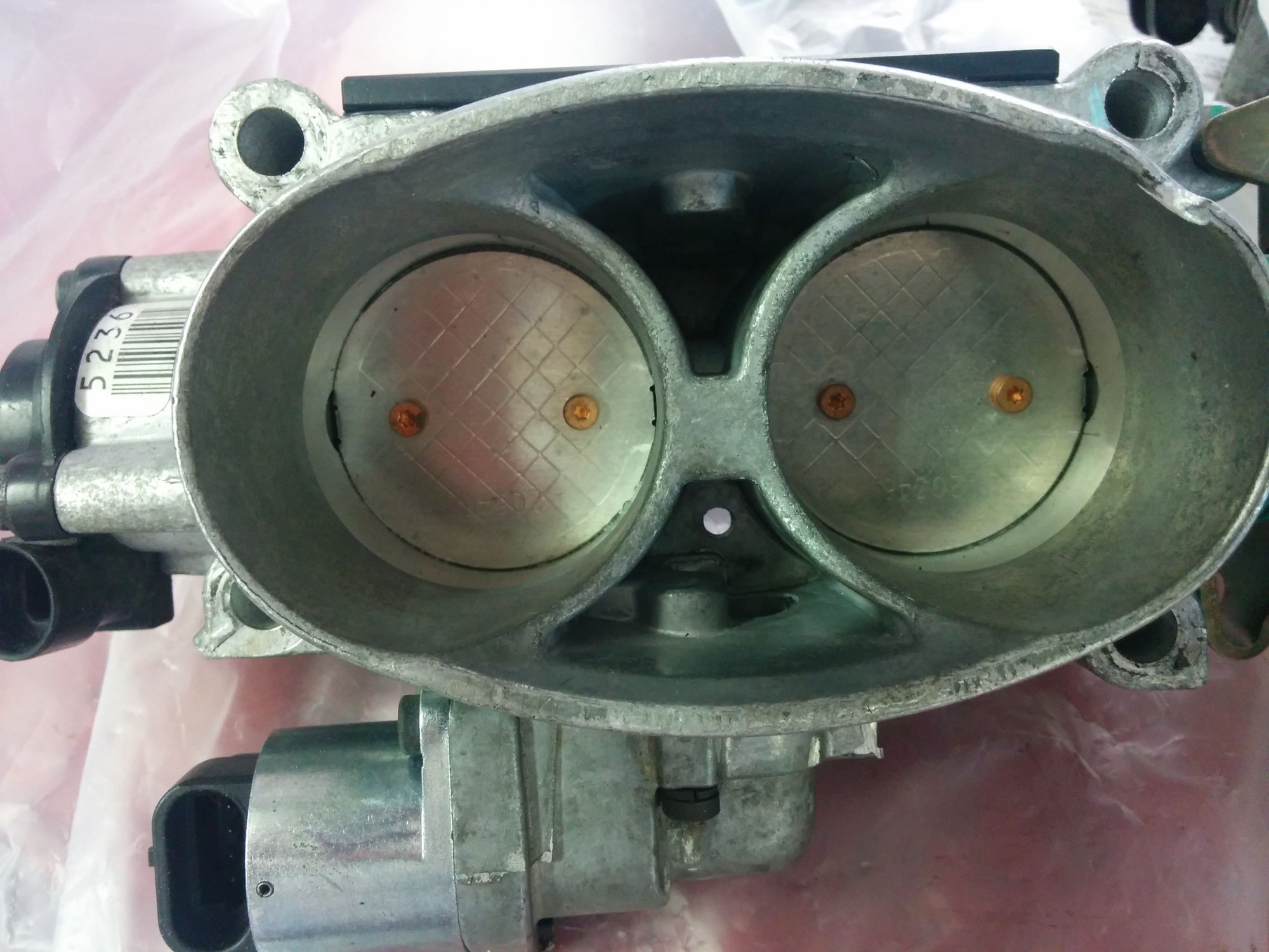

So, I have some aftermarket (holley, BBK) throttle bodies in the shop and I noticed one major difference. In addition to the IAC passage, there is a small hole about 1/8" drilled that provides free air even if the IAC is fully extended (closed).
On the aftermarket throttle bodies, this hole does not exist. I'm not going to run one of these throttle bodies on my LT1, however I'm thinking of putting a #10 screw with some loctite in that hole. I tapped it this AM, and am gonna run out to the store and get some screws.
Maybe this hole is just allowing too much air ? It' on both factory throttle bodies, but again when I googled this problem several people complained about the exact same situation and no resolution in any of the threads.
Starter is all set.
Rear main seal leaks oil though. wtf.
-- Joe
That picture of the factory throttle body seems to be open quite a bit, is that the one your were running and is that all the farther it closes?
It's completely closed. What you are seeing is the paste the factory puts on the blades and the bore.
This experiment was interesting. For about 30 minutes it solved the problem. Was idling around 600 at 160 steps.
