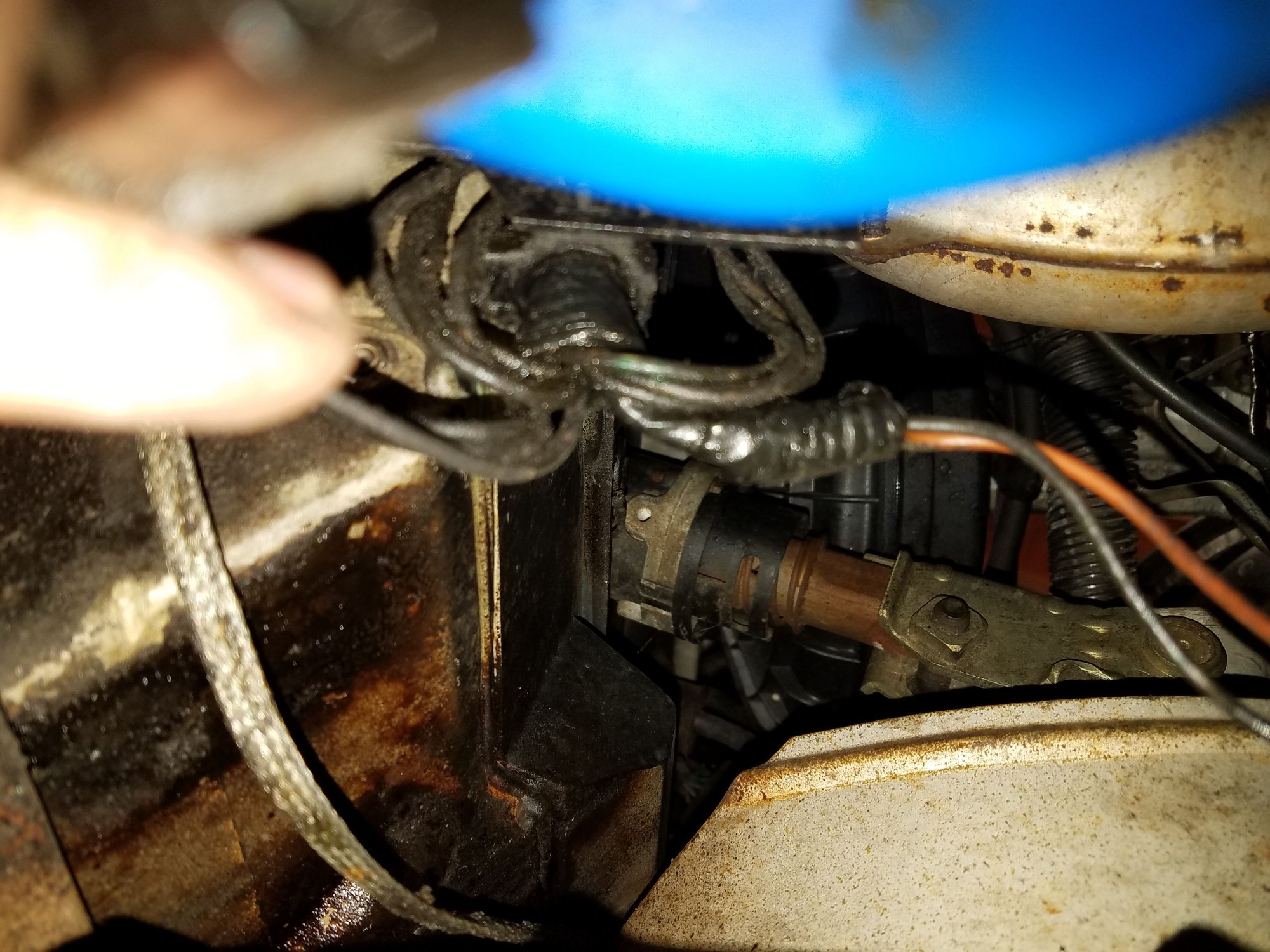

I cannot find anywhere this connects to
  1. It is orange and black
  2. 2 post connector
  3. located on drivers side
  4. comes out of the harness shown in the pick
  5. not a very long wire
  6. nothing I can see screwed into block
I am at a loss. I have looked at some diagrams but don't see it pictured but I admittedly not good at reading them. Let me know what additional details and pics are needed.
Please help if you can.
Thanks!
Wade

Year of the car and pic of connector? Color of the wires?

Purely a WAG of sorts but maybe the MAT sensor to the jumper on an L98 - might make sense for your '90. I believe on a '90 you've got the MAT then a short jumper to the connector in a loom near where your snapshot seems to be.
If my WAG were correct this "jumper" would connect to a weather-pack near where you snapshot seems directed.
http://www.ebay.com/itm/86-92-TPI-In...ZTUB-E&vxp=mtr
That would light the SES light if the bulb not burned out codes 23 or 25 I think

This is a 90. The wire colors are orange and black. Here is the pic of the connector.
The MAF is plugged into the bottom of the plenum towards the back correct? I have that hooked up. So I am looking for the other end of the MAF wire to plug the unknown connector to?
