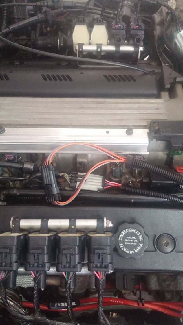

I know I will not have it finished by Friday. But my Samco hoses and clamps should be here Tuesday. I'll just put it together so I can drive it to C&C on Saturday. I miss driving it Then, I'll literally get back to it when I get back from C&C.
And I just had a dumb thought. What if I flip the coil packs upside down?

Can you drill new holes in your existing brackets to move the coil packs up towards the fuel rail covers and away from the AIR and ASR units?

Really good idea! I guess my only question at that point would be, how would I bolt the coil pack brackets down?

Haven't had much time to mess with it. I did flip the first two coil packs upside down, looks like it'll work. I'll see what Taylor says tomorrow. And installed a new heater hose. Waiting on one more though.

So I completely cut out the tach filter?

Not sure on the 93', if you have one then yes. You simply bypass it by connecting the two wires that run into the filter together. I believe in 95' they did away with the tach filter.

Cool and thanks. Yes my 93 does have one. It's a black box looking thing. Does this just stay connected like this? I'm talking about the the one that looks identical to the opti test port. Obviously, I'll make it neater.
