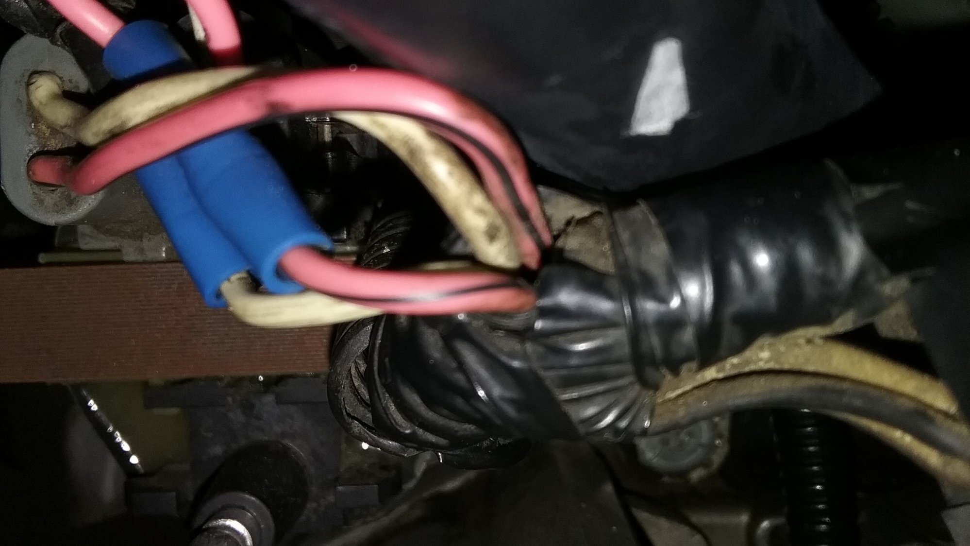

Wires coming a day late. I guess cause of the holidays. Patrick, I was reading your thread for some info. Here's a quote "The two pink wires you solder to the single pink w/black stripe wire on the gray coil connector as well."
So only solder the two pink wires from LTCC, to the pink/black on gray connector? I ask because I see my car has two pink/black wires. And, as you know, LTCC instructions it comes with aren't the most detailed.

Any help on my post above? Asked Bob, but has not replied. Pic for reference.

Bob responded and said to connect the 2 pink LTCC wires to the pink with black on the gray OE coil connector. That is what Patrick said to, but I just wanted to make sure.

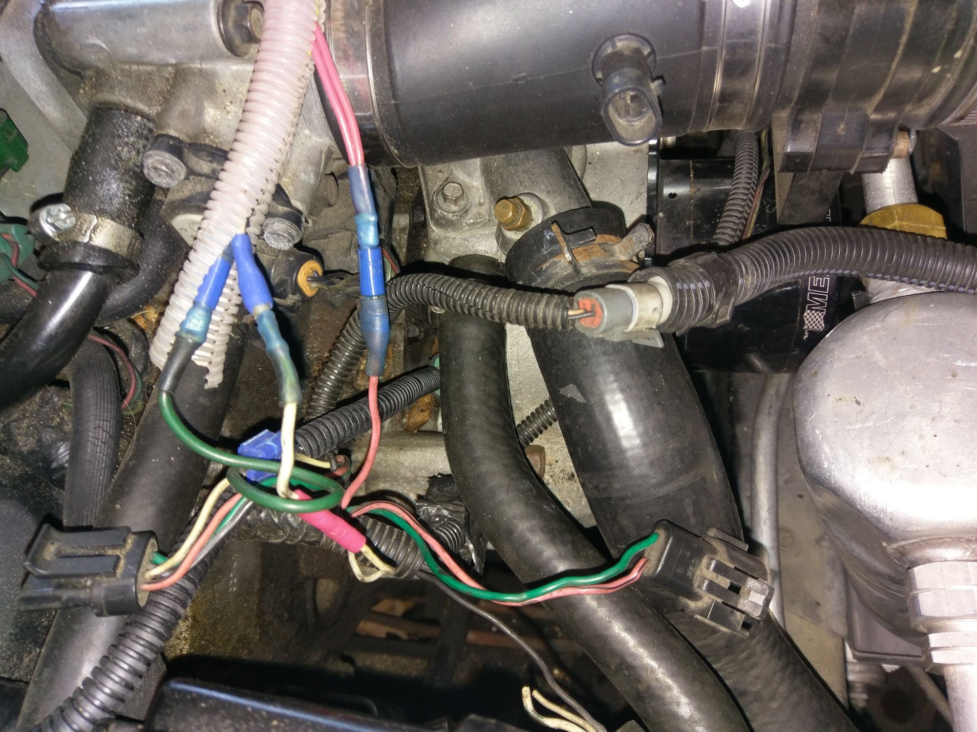

Here's a shot of my mess.

Thanks! Yep, I understood it. Just confused cause I saw the 2 pink with black wires.

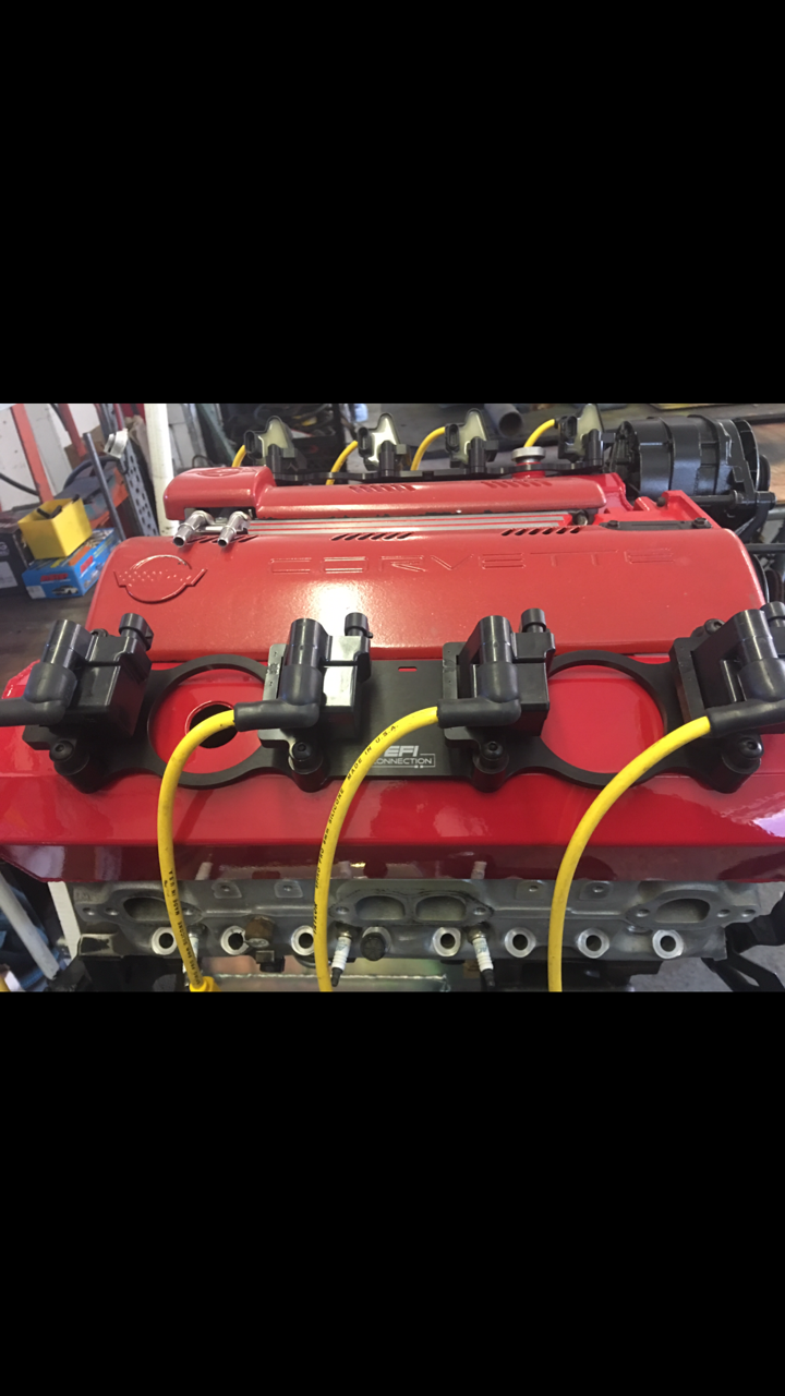

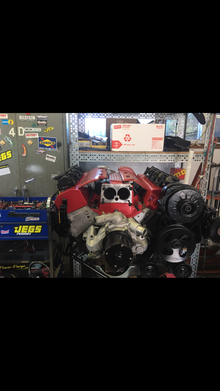

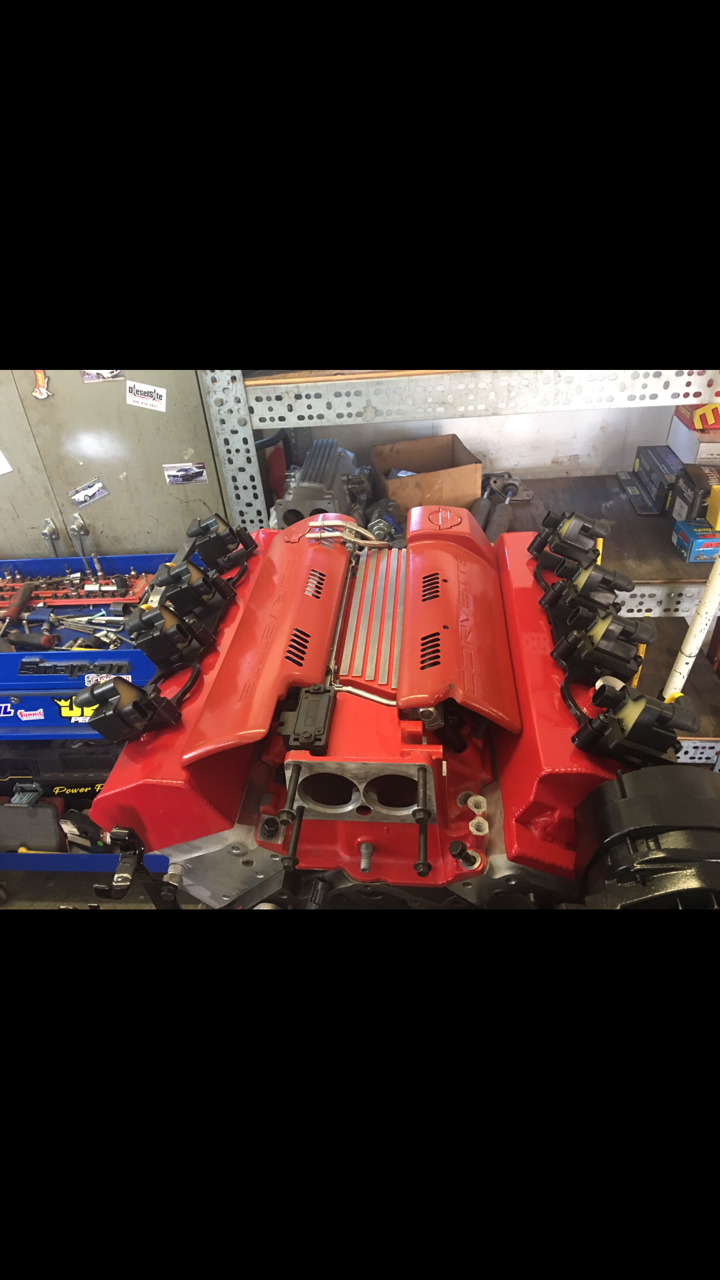

My build is in progress here are my Coils mounted. still in progress

Looks good! Aren't you using the 24x kit? I'll post up my pics sometime this week
