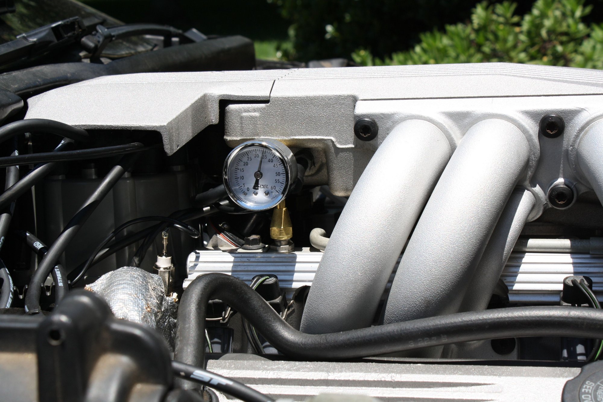

I want to do something like the picture below. I'm trying to figure out what fitting I need to screw onto the Schrader valve and to match up to the gauge giving me a 45 degree angle. I know my gauge is 1/8 NPT Male.

I got this Accel gauge. That angled gauge looks better. Unscrew the valve and screw on the gauge.

Did your gauge come with the adapter to hook it to the fuel rail? So far none of the ones I have looked at come with the fitting.

The GM Schrader is #4 AN. Earl's has all sorts of adaptors. I stock a few. You can see them in my Sales Guide available on-line under the downloads section. I suggest the AutoMeter electronic gage though as this way you can view it inside the cockpit. You do not have to do a permanent install - leave the gage in the box and use it as a test tool as needed. Being able to read fuel pressure while driving is often critical to solving many issues !

that fuel gauge is on my 85. basically, I got everything from fleabay. you need the fuel rail adapter, and replace the 90° elbow with a 45° part. the gauge is a marshall liquid filled - again fleabay. hope this helps....
