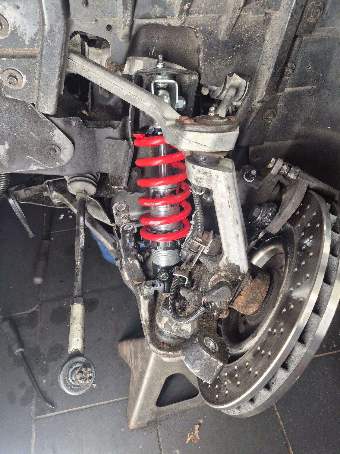

Default Just did this and WOW
I just installed this coilover setup based on the p/n's in the origional post provided but the OP. I'm thrilled how GREAT this worked out as all the parts seemed to still be very affordable and the rusult from the driver's seat is amazing. This is how the car should have been built origionally. Before I knew about coil overs... I looked for a Z51 front spring for 2 years with no luck. I found many sellers trying to pass off a standard spring as a Z51 btw, so lots of wasted time there. Then I came across this thread and found this encomonical way to give coil over a try while not wanting to spend 3000+ on a "kit" which didn't seem as good as this setup for many reason.
1. The ride quality on 2 clicks compression 5 clicks rebound is wonderful. Its comfortable and very forgiving while being more controlled No more the bottoming, and I have it setup much lower that stock ride height.
( I dont understand how this is possible....more control, lower ride height, and better ride quality. )
2. Handles better then stock on very conservitive settings.
3. Far less cowel shake and chassis jiggle compared to stock springs and new bilstein shocks. The car doesn't feel like a junk box over rough roads anymore. Something I no longer have to accecpt. It feels closer to a modern Porsche quality (I have an convertible X brace too). I'm very suprised bu this since I rigid mound the top eyelet.

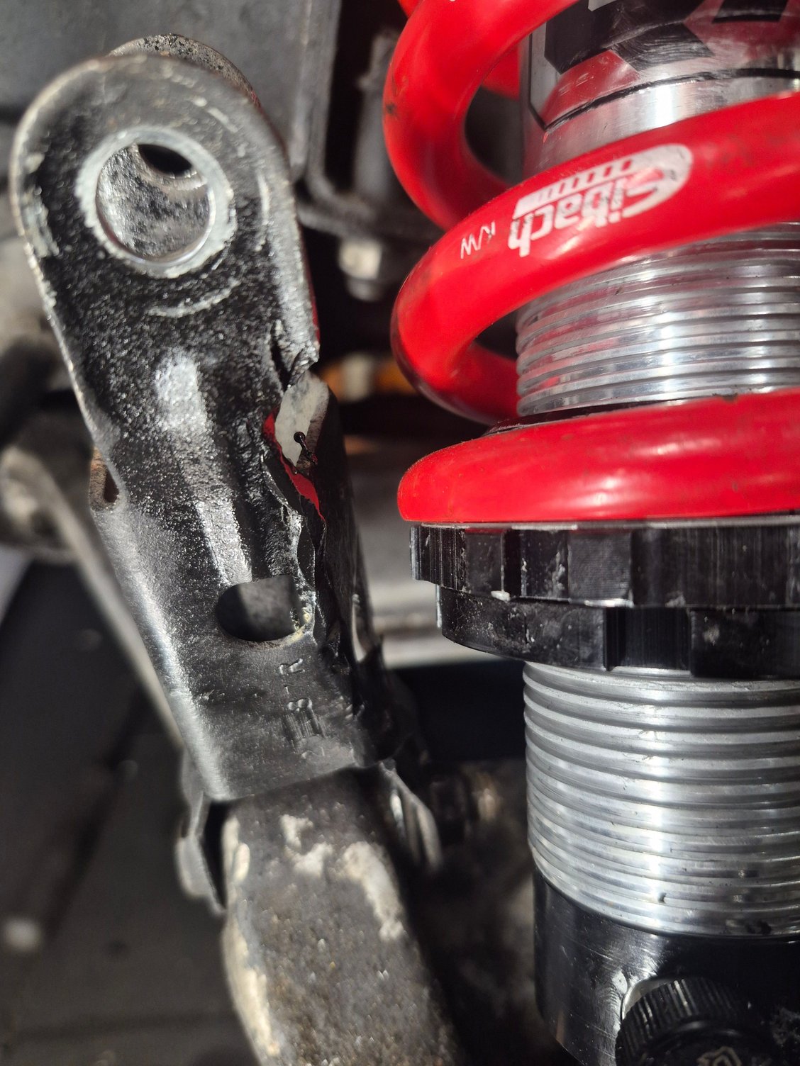

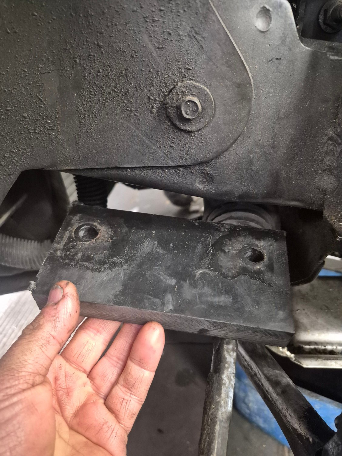

4. I did need to trim and re-weld the stock sway bar link, I sliced it and simple made it more of a triangle shape by about 1/4 of and inch. I also spaced down the swaybar mount with some 3/4 inch thick delrin sheet. Nothing hits or clunks.

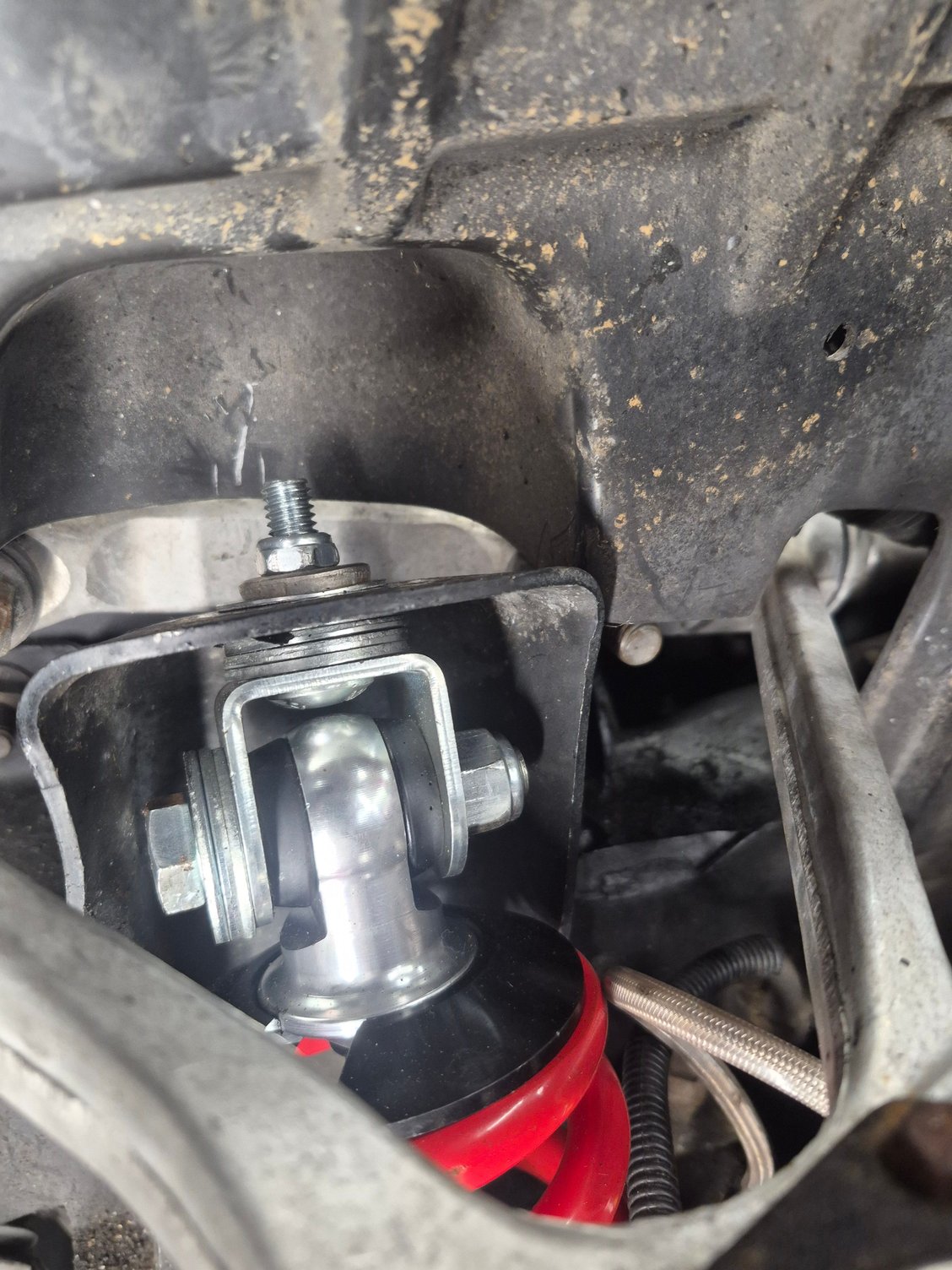

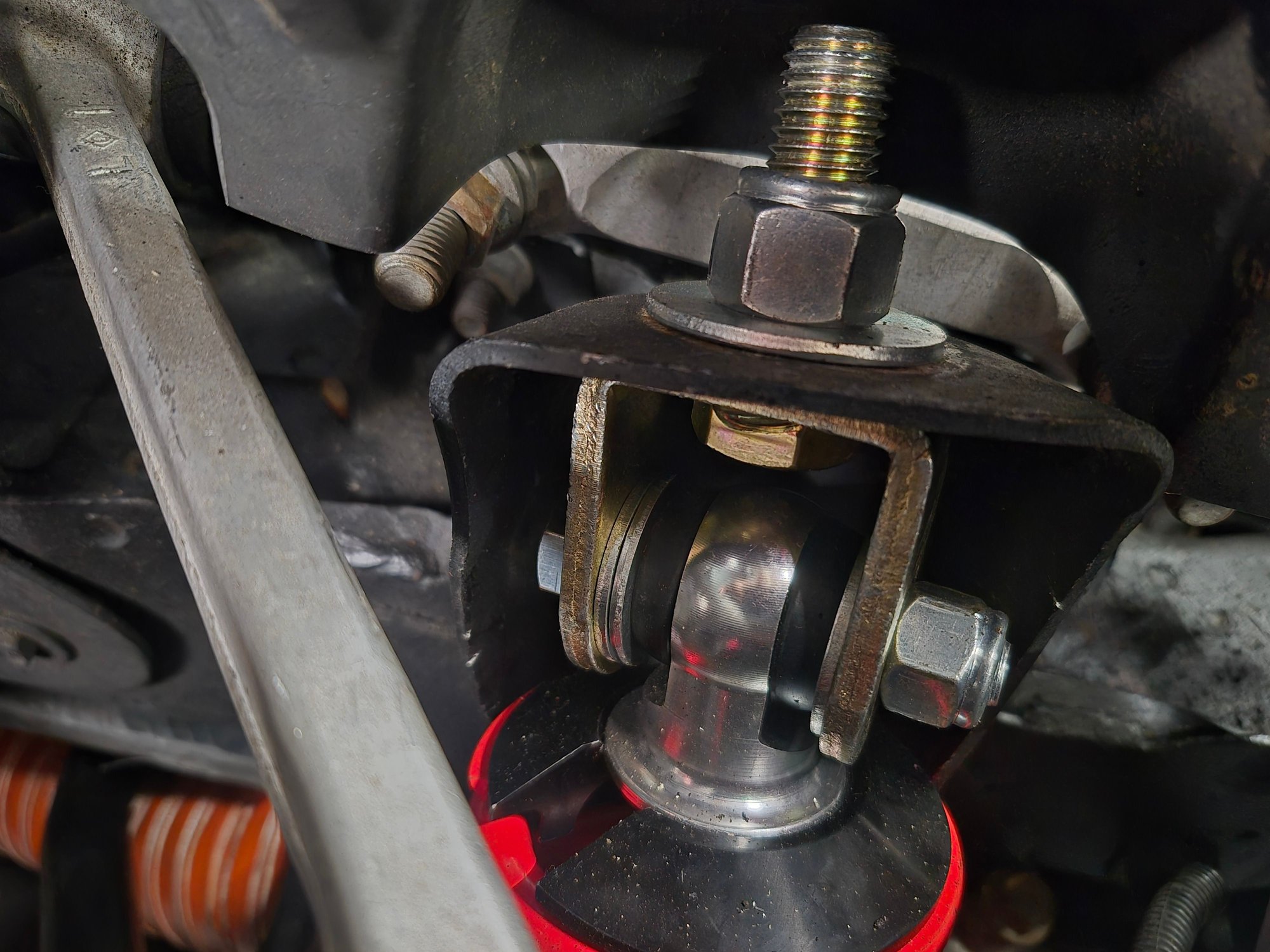

I would like to make a few changes and 1 suggestion reguarding the the upper shock mount. The upper shock mount specified by the OP seems a bit thin.... so where can I get the upper shackle shown in post 89 (https://www.corvetteforum.com/forums...post1600850546). Perhaps I should simply box weld the back and 1/2 the front with some 3/16 plate. And add a larger grade 8 through bolt. I'm also afraid the suppled 3/8 cariage bolt might not be up the stresses of track duty.
I would suggest NOT using a rubber bushing as show in post #1 by the OP and most it solid as in post 89. I thought the solid mount would be harsh since the C4 is already harsh over broken pavement and I was willing to accept that since I use my C4 only for track days. In reaility it is far less of a harsh ride then the stock setup. I cant really comprehend this at the moment. It's often said, "Any sufficiently advanced technology is indistinguishable from magic" and "magic is just science we don't understand yet". This setup is magic.
3/4 delrin spacer with M10-1.5 x 60mm bolts.
Not loving this upper shock mount, will been to be boxed and need a stronger bolt.

P/N 690001 is a better top mount. It's far more heavy duty and the appiication is 2004 Chevy Avalanche. Six 5/8's washers help to make it fit right in the through bolt area.
