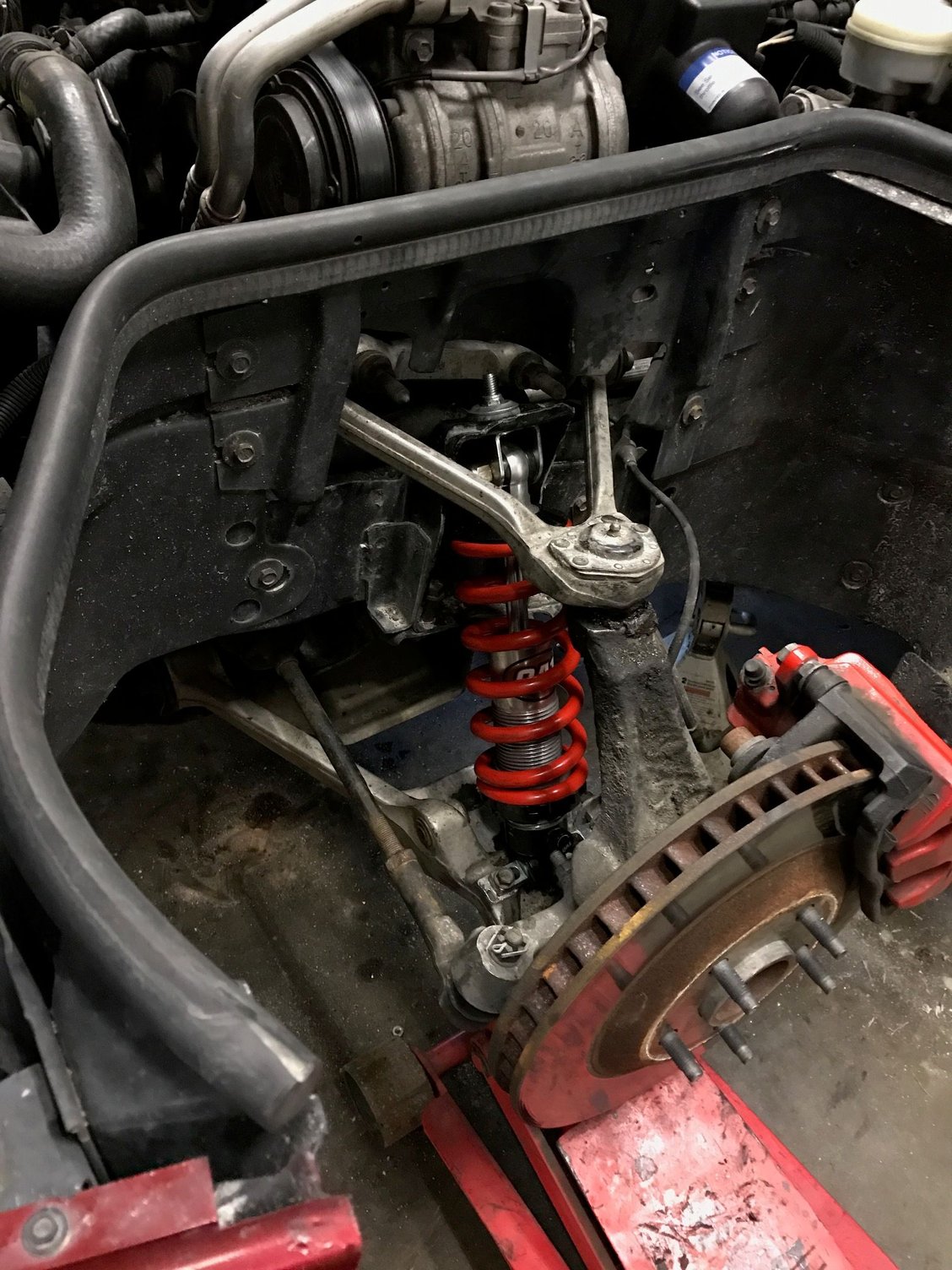

It seems that Coilovers are always a debated topic for one reason or another. I decided to switch over to coilovers for 2 reason.
1.) The cost in reference to a new leaf spring
2.) Ride height adjustability
So Ill start with a cost breakdown, then I'll go into selection, and lastly installation
Cost Breakdown:
(2) QA1-DS304: $327.94
(2) QA1-BAR350K: $43.94
(2) EIB-08002500450: $119.94
(2) QA1-SS200SD: $33.94
Total Cost: $525.76
Cost if I kept Monoleaf and just changed shocks
(2) QA1-TS511: $297.98
So, the cost difference to go to full coilovers is: $227.78 whereas a new leaf spring is $500+. You also have the capability of changing springs for roughly $50-$60 per.
Selection:
Bilstein Factory specs:
Extended: 13.56''
Collapsed: 10.18''
Now, QA1 makes all of their custom mount shocks with eyelet ends. The problem being the factory upper mount is a stud style. They make a stud style adapter to remedy this problem but I dont like the idea of how the force is applied to that stud as the suspension goes through it's motions. To solve this I used the QA1-SS200SD which convert the eyelet into a stud mount utilizing a clevis style setup. This eliminates the rotating motion on the stud. This adapter also adds roughly 1'' to the lengths on the shock so I had to take that into factor.
As previously stated all of the coilover shocks are eyelet mount so I also had to convert the bottom to a T-bar (this maybe adds 1/8'' to total length) using kit: QA1-BAR350K
So this narrowed it down to one shock
DS 304:
Extended: 12.625 (to roughly 13.625 w/ adapter)
Collapsed: 9.5 (to roughly 10.5 w/ adapter)
At first I though the added 3/8'' of collapsed length compared to the bilstein shock would be a problem but the factory front shock qa1 sells for it has a collapsed length of 10.625 so I figured I'd be alright.
Ok, so now I have my shock selected, my adapters selected, all that is left is which spring.
Spring Selection:
I decided to look around at other kits IE DRM and Van Steel to see what rates they use. This lead me to choosing a 450 lb spring. I also took ride frequency into factor which came out to be roughly 1.93hz. So not too bad for a street/track car. I could write a huge post on all that I looked at for this but that isnt the point of this post
The best part:
Installation
I took some pictures for reference but the procedure is as follows:
1.) Jack Up Car
2.) Remove Wheels
3.) Remove original shocks
4.) Separate lower ball joint from spindle
5.) Remove (4) monoleaf mounting bolts
6.) Remove monoleaf (Its a pain!)
7.) Reinstall mounting brackets without the spring (this will makes sense when you get there)(I put the back on because the bolts go through two pieces of the car that are welded together and will hopefully help the two pieces stay together. Maybe it wont ever matter but I was already there so why not)
8.) Clearance Sway Bar Linkage
9.) Slot sway bar mounts to push forward roughly .25''
10.) Reconnect lower ball joint
11.) Install Coilover shock
12.) Put wheels back on
13.) Set ride height
That list a rather vague but it's just the general idea of what goes into it, it took me roughly 6 hours from start to finish but I was in no hurry and took my time.
You can have a thread like this without pictures!!!
I didn't go too crazy with photos, only have a few and my phone rotated them 90 degrees but you get the just of it. Also, my suspension is not not spotless haha, I try to drive it atleast once a week
Sway Bar Linkage Clearance: ( I worried about the strength of the bracket after cutting on it but, that section still has a larger cross sectional area versus factory sections so I didnt worry too much about it)
Installed!:
Installed:
At factory ride height there is about 2 inches of travel in the shock left which correlated to 6ish inches at the wheels so I'm not concerned.
If you have any questions feel free to ask here or PM me!
Thanks!
Colton
