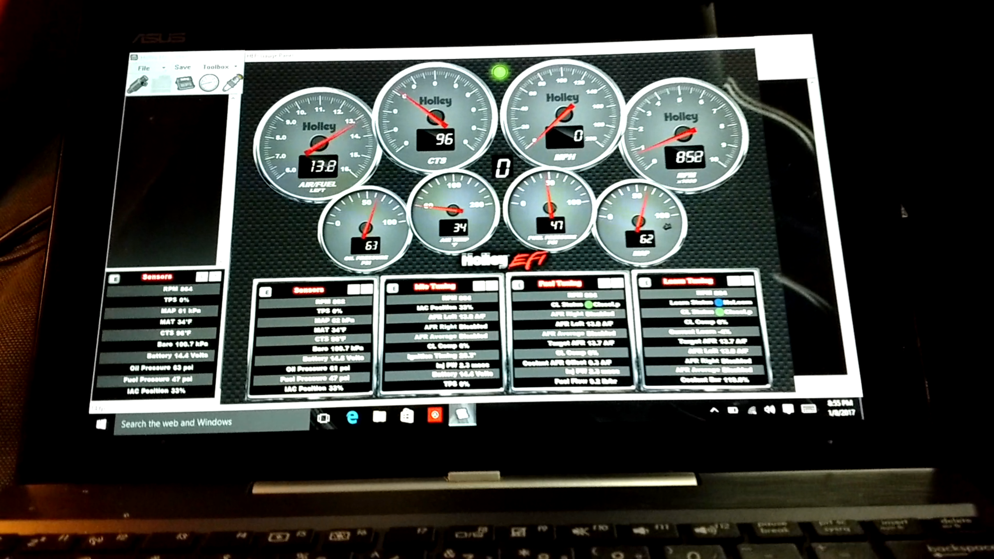

I run the Holley HP in my 85...completely eliminated the old one off 85 ECM...best thing i ever did...had mine professionally installed and tuned. No more one off 85 MAF sensor either. Coverts to MAP...no more MAF relays either. For the early C4's it's a no brainer in my estimation.
And forget about you think about camming a MAP car vs. MAF.....this thing is idles like OEM and is self learning. Today's technology is light years ahead.
