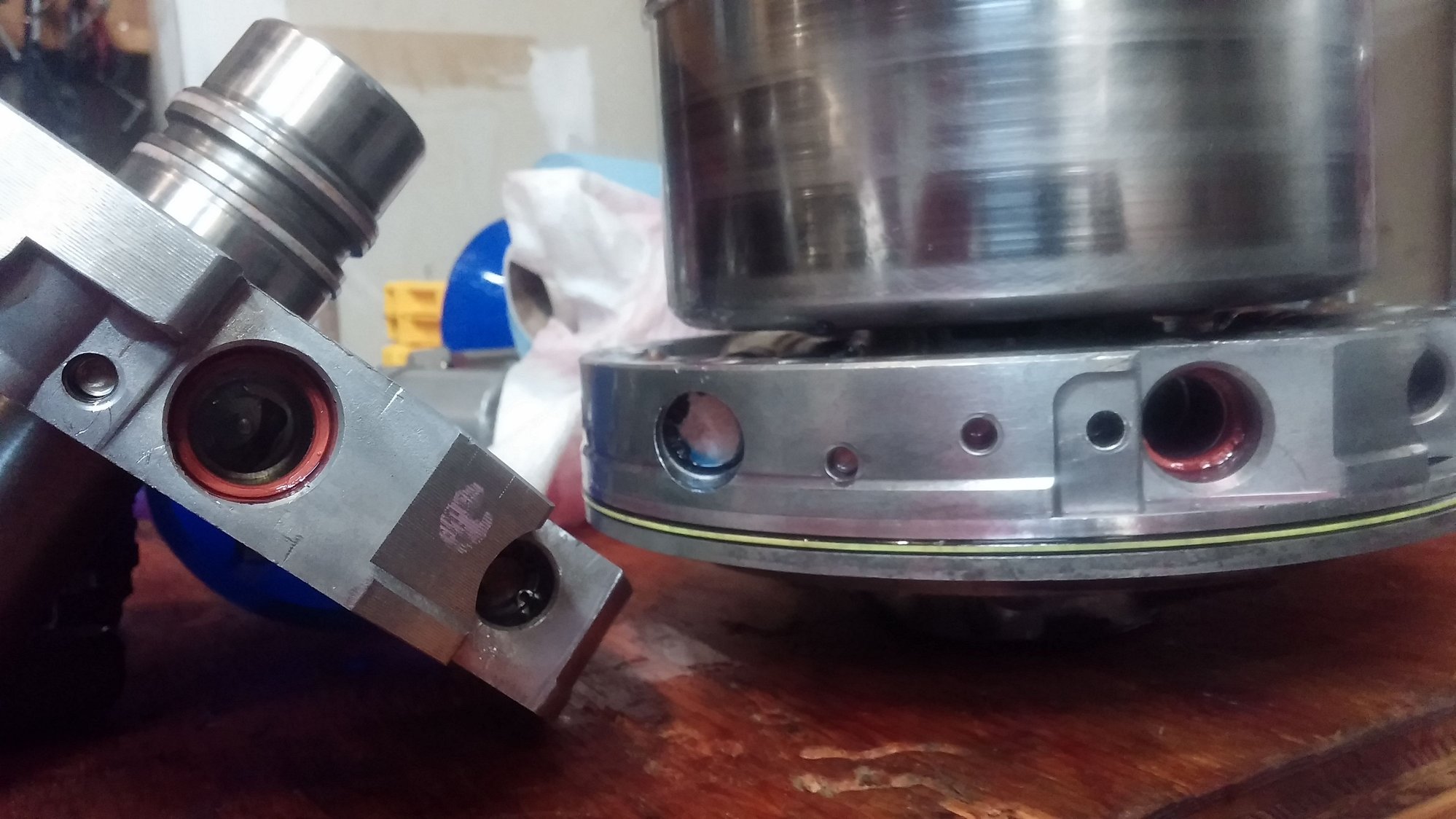

Well i got a wild hair today after two energy drinks...
Transmission pulled, and i did a detailed wet air test following instructions on sonnaxs website.
I found the forward passage way in the pump totally blocked.
The culprit was a cup plug that the rebuilder at transstar, the cup plug for the forward passage way was way to far in.
Resolved by drilling a hole, inserting a screw down the center, and then pulled out with my slide hammer.
I pulled another cup plug from my old pump and reinstalled, the staked it in place.
i also noticed some weak staking in the new pump compared to the old pump, so i gave all of the cup plugs a once over.
Tomorrow I'll do a detailed check, and then get it back together.

Not sure if this is visible, but the old pump on the left, new pump on the right.
Cup plug was pushed to far in, redirecting fluid...
I have noidea why removing the boost valves fixed the issue for a few minutes, super weird affect.

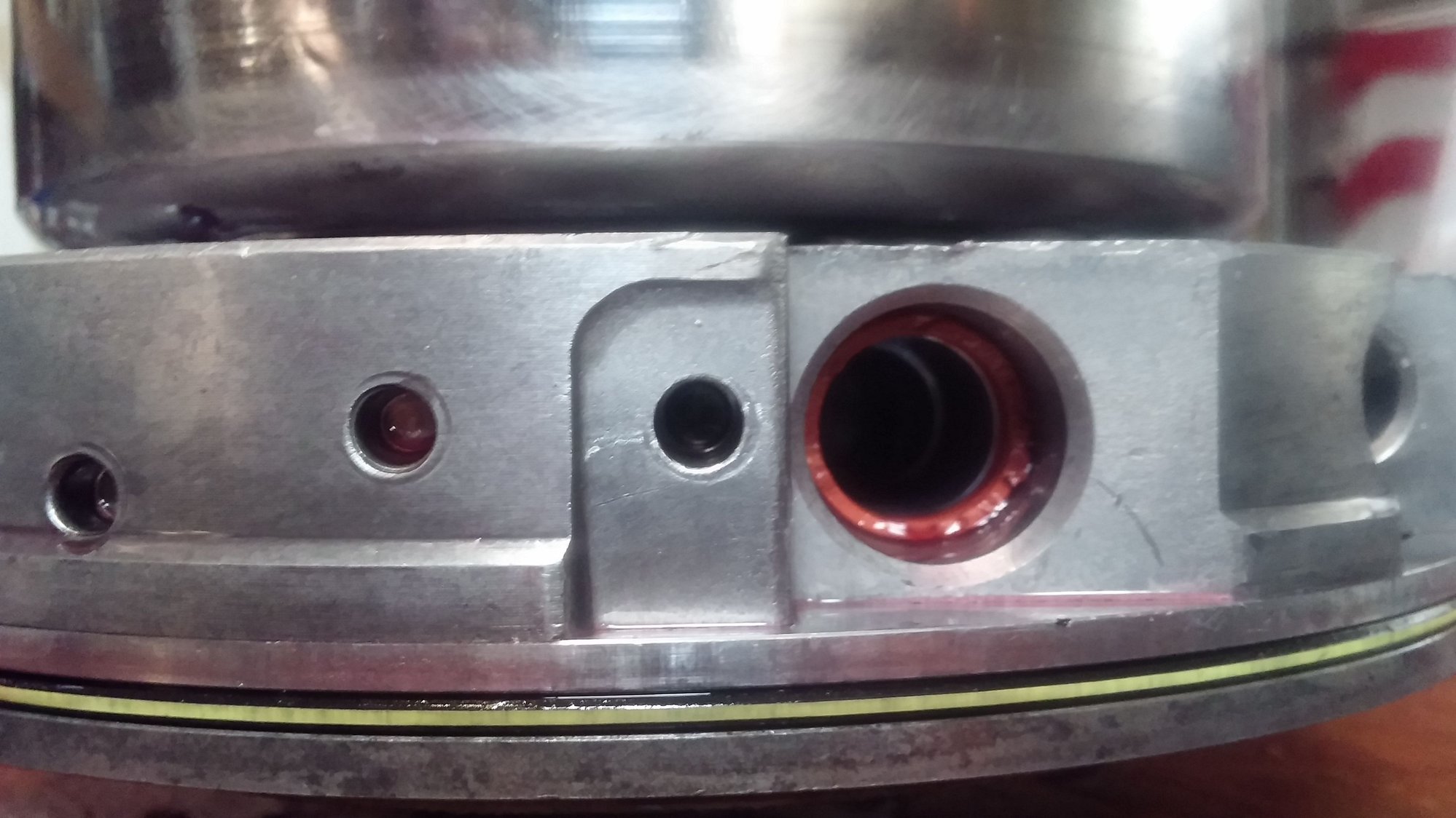

Small hole to the left of the filter seal.
Close up of missing cup plug.

I spent much of saturday comparing the new pump to the old one.
i found a few other slight issues and corrected them.
biggest other issue was a missing cup plug/air vent for the "line" circuit that's connected to the forward circuit.
I looked like that area was enlarged so the cup plug from the old pump would not fit, however the old pump had another vent plug that did fit after i enlarged it slightly.
I could not find much about cup plug locations for the pump.
