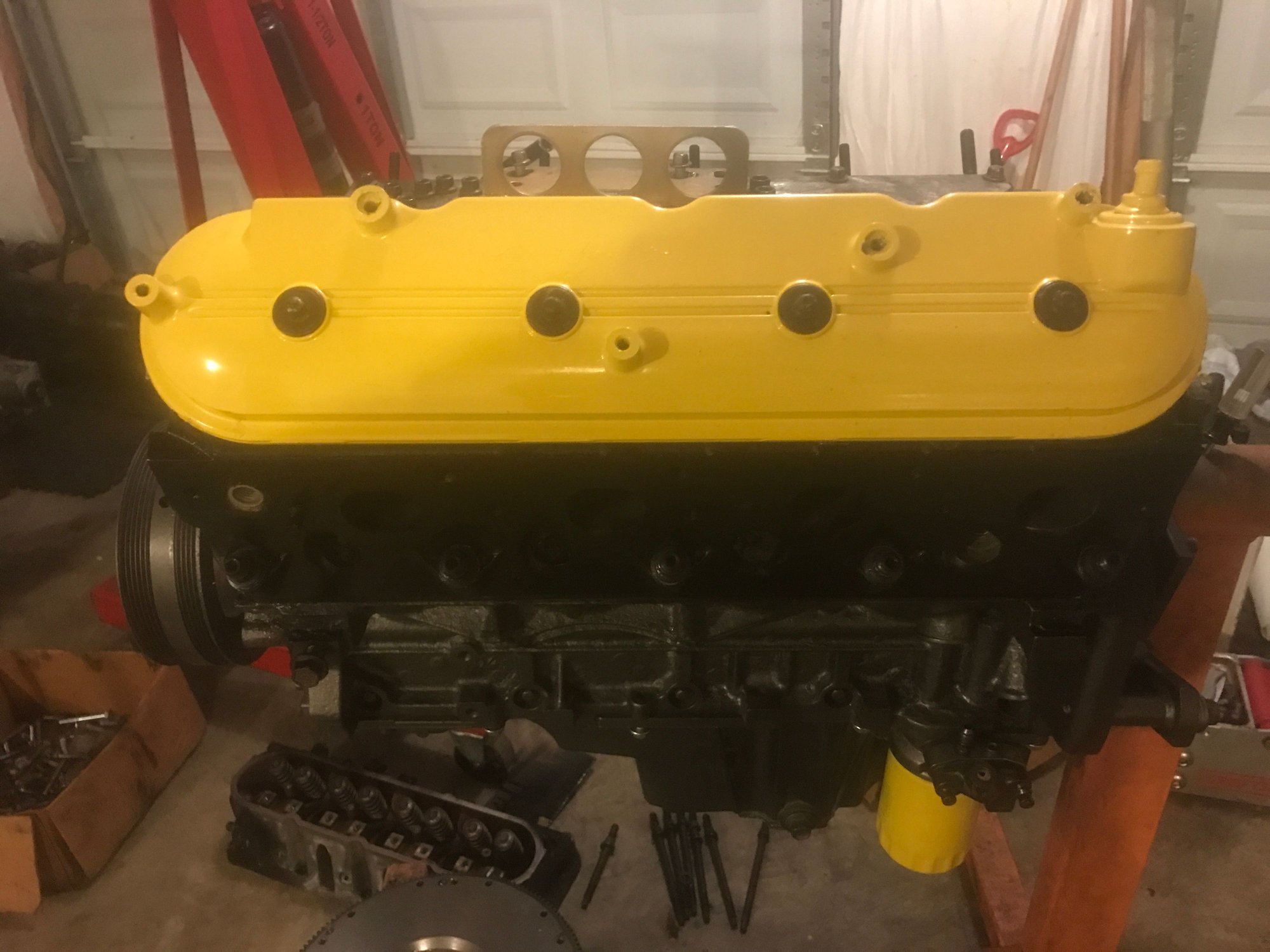

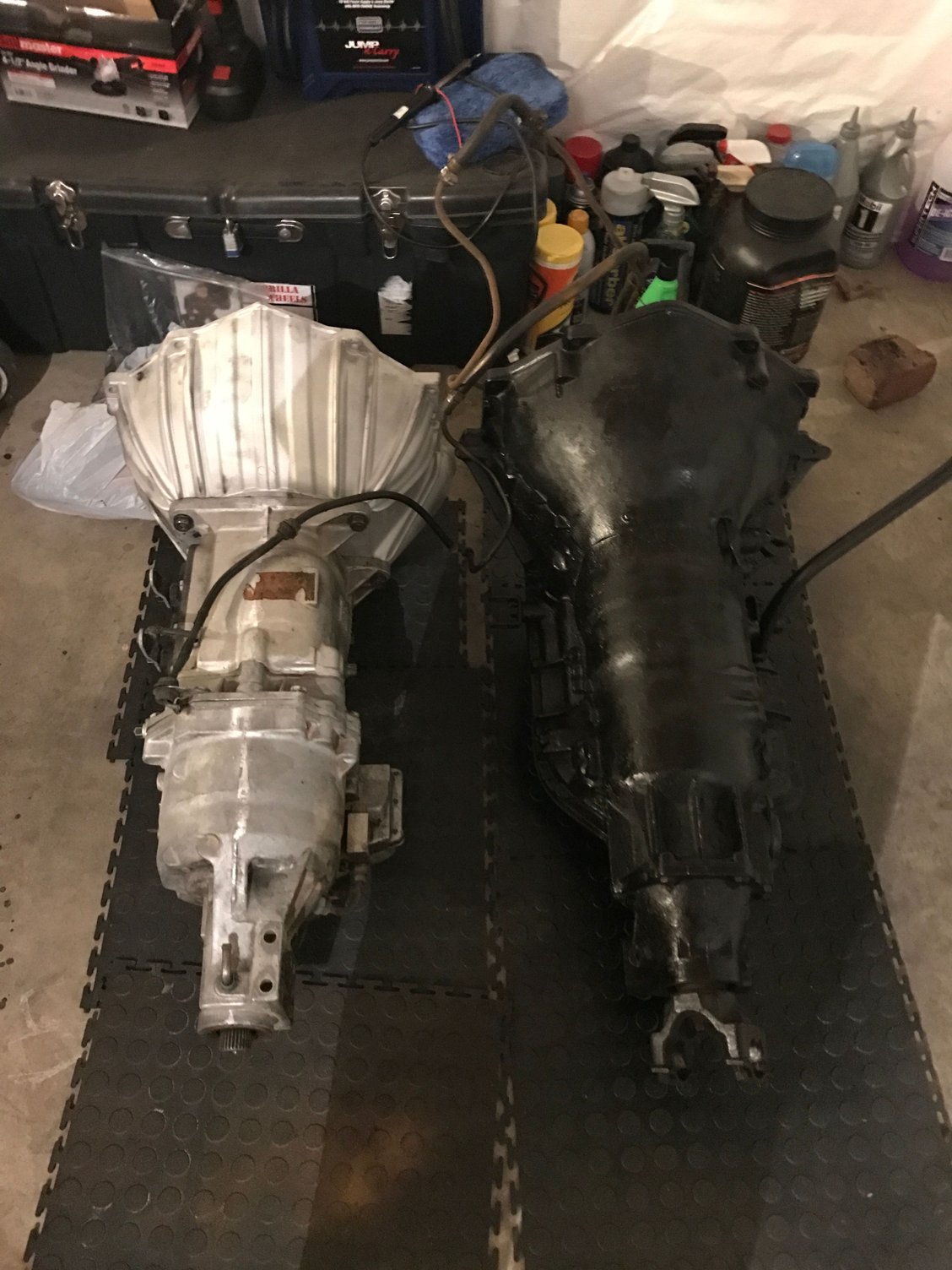

A few updates-got both heads torqued down yesterday. This weekend I'll be installing the pilot bearing, flywheel and clutch and then mating it to my tranny to see how many shims the hydraulic tob will need. Soon after I'll be able to get the tranny back in and then the engine. 4+3 beside a th400

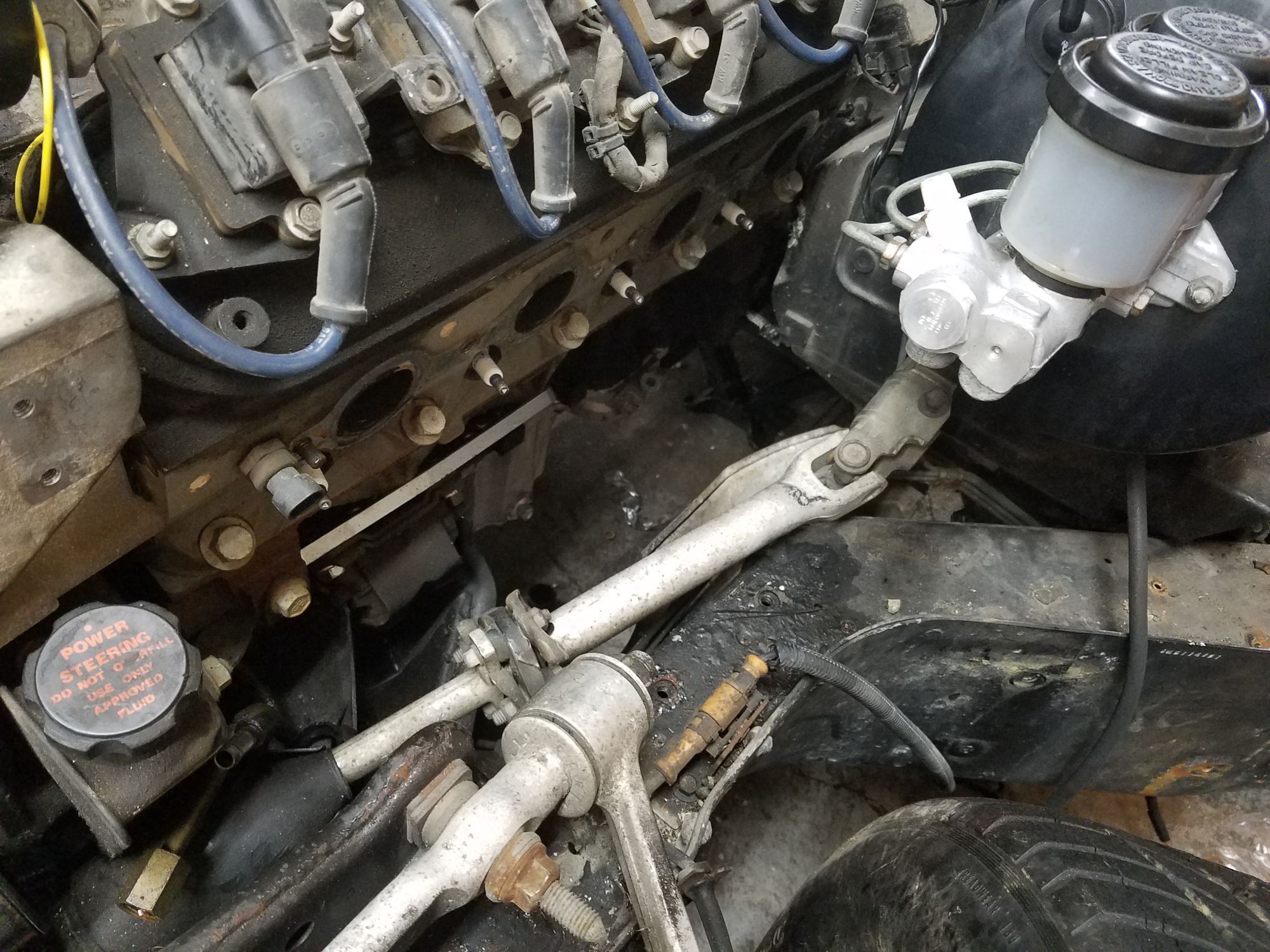

Pics are from joenova on ls1tech. Hopefully he doesn't mind.
Originally Posted by dclafleur
I didn't see it mentioned which LS plate/motor mount combo are you using? Seems to make all the difference in where you end up having to make clearance.
can't remember which vendor I bought mine from on eBay but they're all pretty much the same design-the adapter is bolted to the block and the stock mounts bolted to the adapter plates.

Yeah, I'm more just curious forward/backwards offset from stock more than anything else. If/When I swap mine it'll likely be with a T56 backing it (I'm running a T56 now) but as screwy as it seems the dimensions between an LT1 T56 like I have and an LS1 T56 are different I'm just always trying to figure out how many parts I'm going to have to piece together before I get started!
