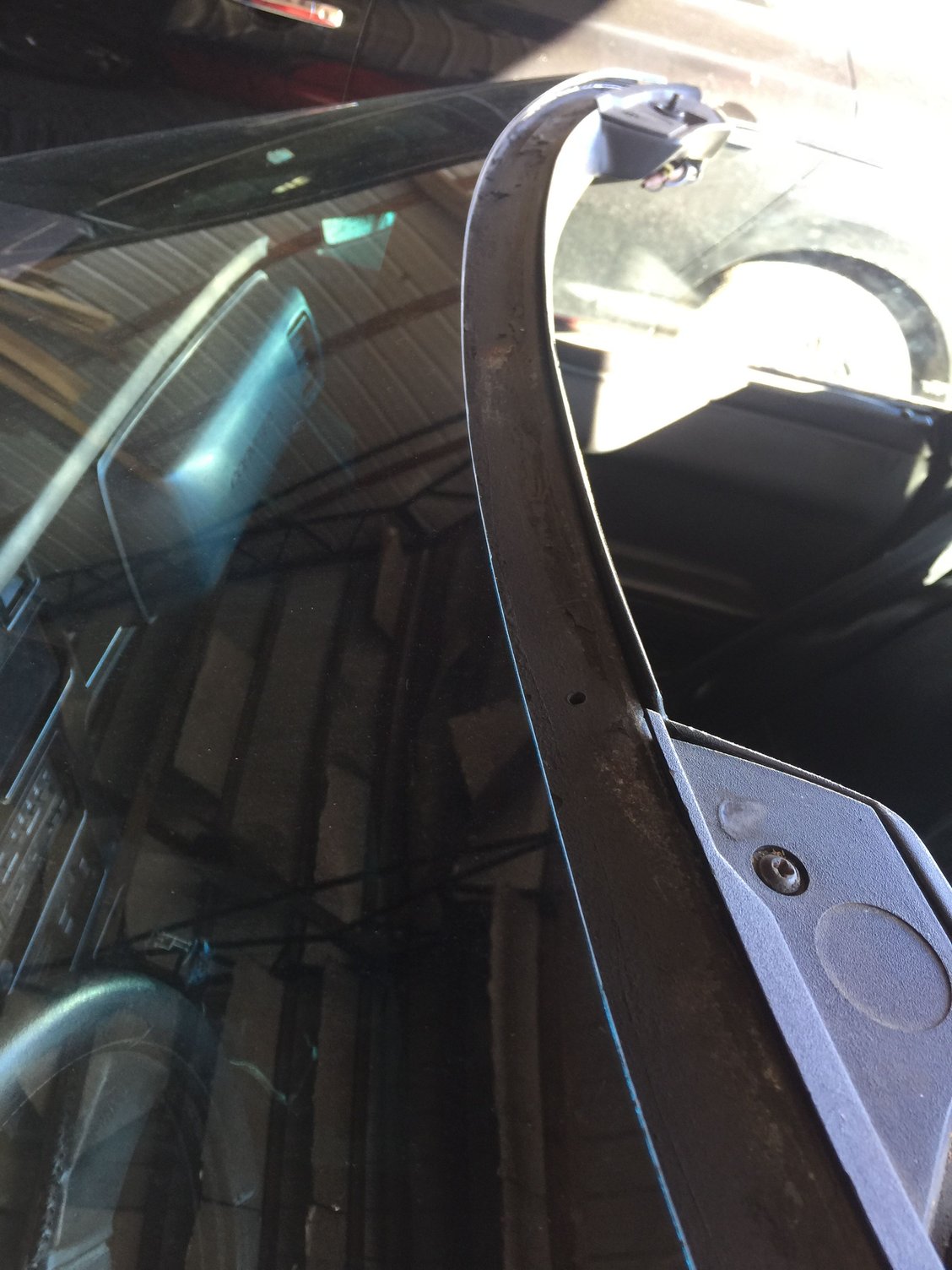

The bolts were working themselves loose. Also there is no weatherstripping so that allows it to rattle.

Just an update-added weatherstripping to the top of the windshield and tightened the bolts down. No more rattle! Hope this can help someone else in the future.
