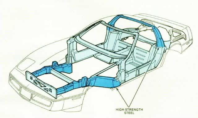

You shouldn't have to run a ground all the way back to the battery. The car has plenty of metal in the bird cage to act as a ground path.
