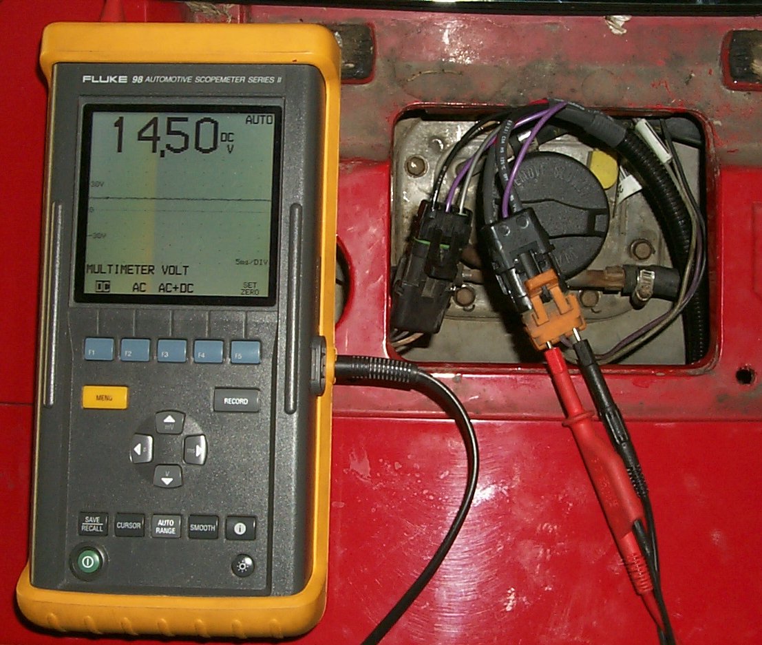

Installing the harness is a breeze!
Remove the cover around the gas fill cap.
Mount the relay and spiked ground lug as shown in the ad pic here using plenty of silicon grease supplied: http://www.racetronix.com/images/C4/...y_Mount-01.jpg
Run the cable with the Delphi connectors up the fill cap area and plug them in as shown here: http://www.racetronix.com/images/C4/...olts_RX-01.jpg

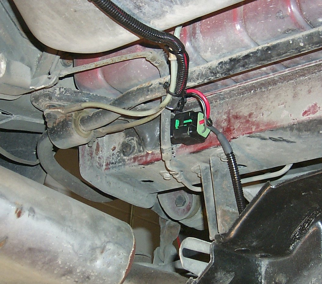

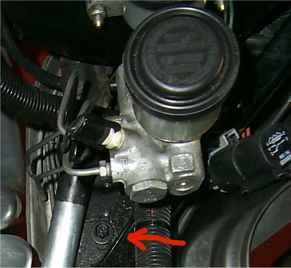

Run the wire with the fuse holder under the car along the driver's side and up to the alternator as shown in this ad pic: http://www.racetronix.com/images/C4/..._Hookup-01.jpg
Keep the harness away from hot headers / exhaust.
Mount and connect the fuse holder as shown.
Wire tie the harness in place to make sure it is secure.
Some people opt to run the supply line through the body side channel / molding. Either way is OK.
Install the battery nuts and body ground upgrade as shown in these ad pics: (use silicone grease on the body ground)
http://www.racetronix.com/images/C4/..._Ground-01.jpg
Jack :cool:
