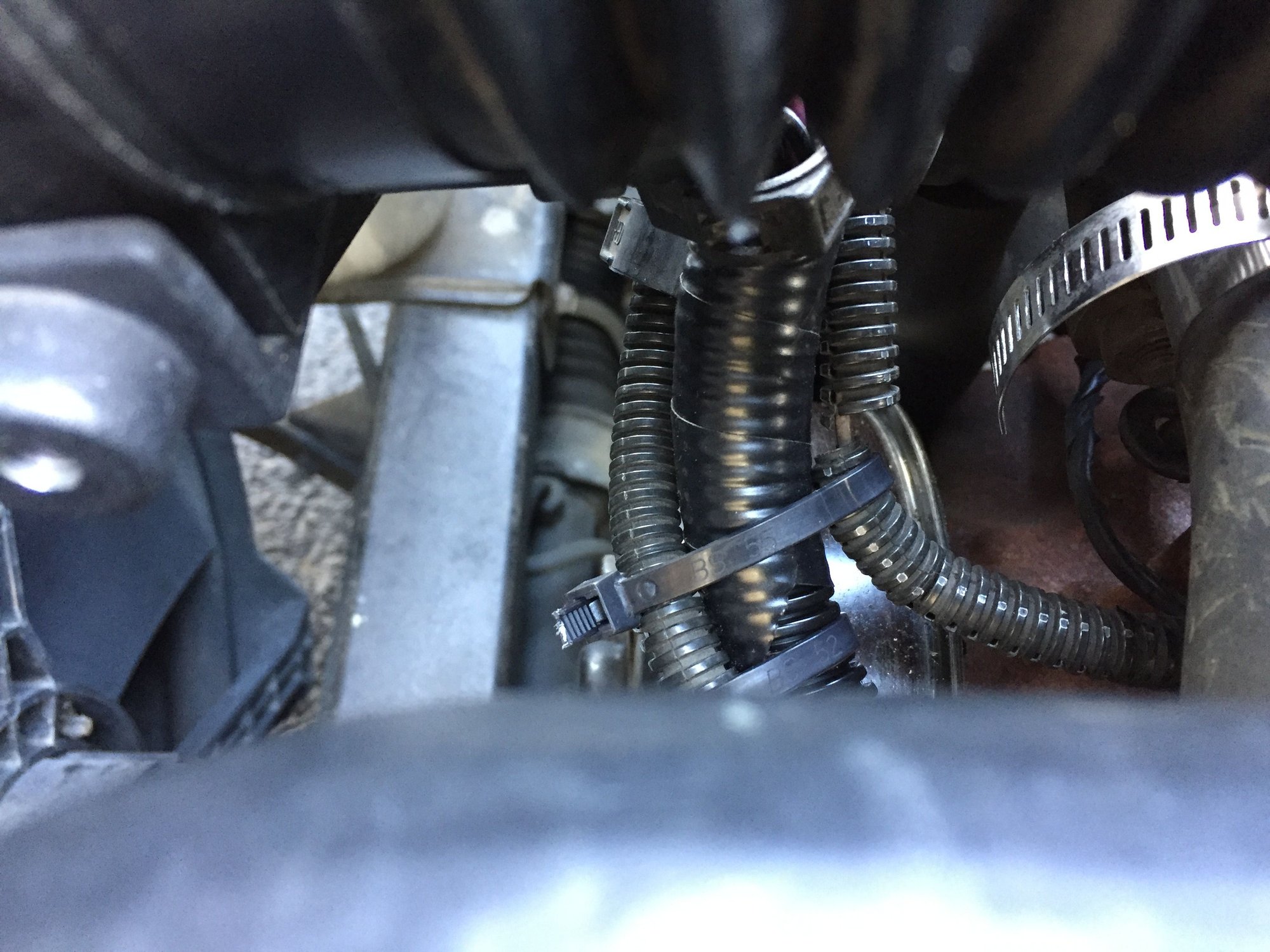

Swapped out my two MAF relays and cleaned the MAF with MAF cleaner. Also cleaned the connector. Still a code 36 although the car ran much better with not too much of a rich smell. Today I was looking at the MAF harness and saw that it was close to a pulley. Closer inspection it was at the pulley which had eaten away my black wire and was getting at the green and purple one. I re-spliced the wires and routed it safely out of the way. No more code 36. Hope this helps someone else. Thanks to all of the replies.
Kevin
