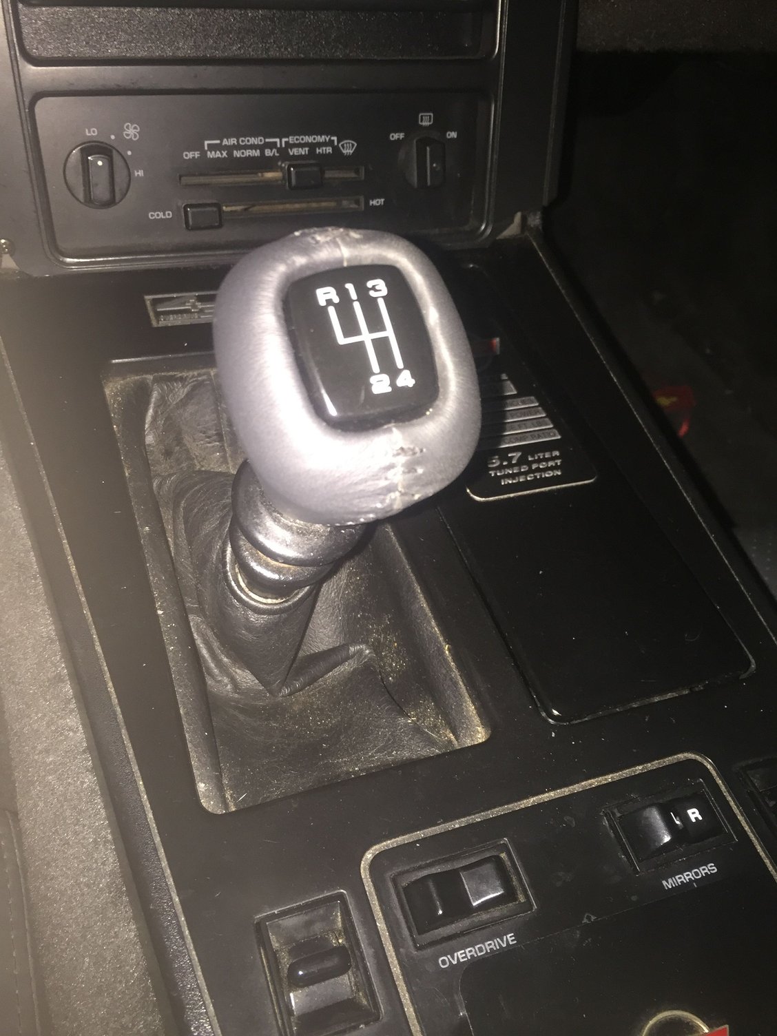

Sounds like the shifter has been changed as well because you have one with the button on the top. (There is actually no need to swap the shifter so that’s interesting). The cars that don’t have the TV cable for kick down use the TCC function on the ECM. I guess your ECM is not programmed this way because the car was originally fitted with a TV cable style transmission.
Yes it appears they swapped everything. They must have had the intention of converting to the button switch because it’s cooler, but probably realized it was more involved. The k-n-o-b and button were trashed, so I replaced those with factory. This is the only cosmetic repair I’ve done to the car so far lol. 60 for the leather wrapped handle, 25 for the button. But it’s a joy every time I use it. Worth the $$$.
So there’s 3 cables on my throttle body: one goes into the firewall, one to the cruise control, and a third mystery cable that disappears behind the intake manifold. Im guessing this is the remnants of my TV cable, which serves no purpose anymore. There’s no cable on my trans, either.
I’m ok without the downshift function tbh, I just want my OD as a fifth gear, which is how it currently operates when it’s actually working. I just need to iron out the intermittent operation...

The only thing the TV cable does is adjust line pressure in the OD unit (how firmly it shifts). The ECM knows nothing about it. It simply requests OD, which triggers the relay, which sends +12V to the activation solenoid. There is also a pressure switch inside the OD that will keep it from activating if the line pressure it too low. Electrically it's pretty simple.
Good stuff. I’m going to follow this line of reasoning and swap the relay for $25. I know my fluid level is good. I’ll let you know how it turns out. Again, I’m not concerned about the downshift function- so if the relay fixes the intermittent ops, I’ll be a happy camper. Thanks again.

The throttle valve cable controls the line pressure, downshifting, and the shifting feel in the transmission.
So how do folks bypass the downshift function to make OD operate like a fifth gear (on or off)?

Yeah the one disappearing over the back on the Engine is the TV cable. If operates in the opposite direction to the throttle cable and the cruise control cable if that makes sense. It must be just tied up under the car some where.
