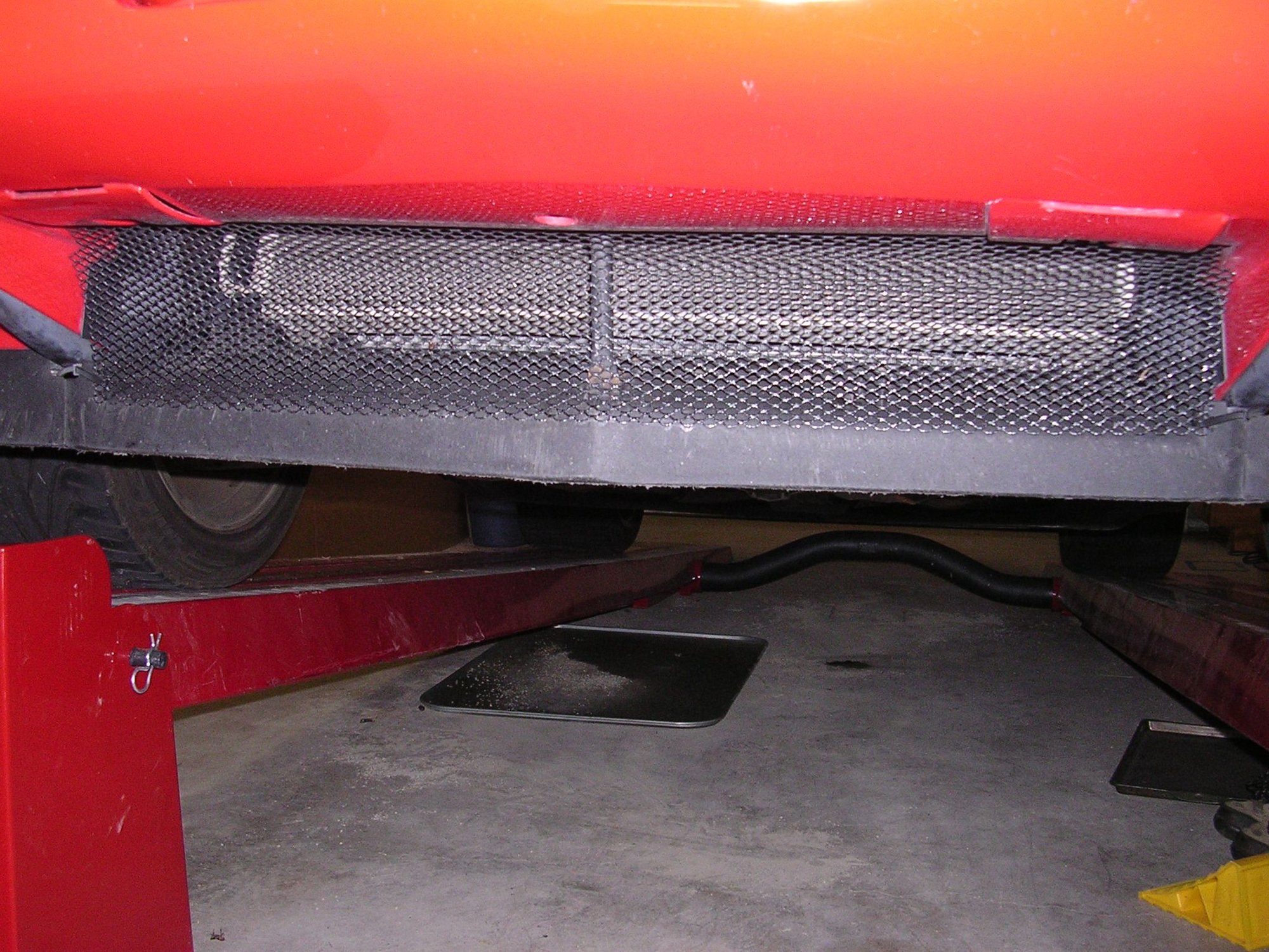

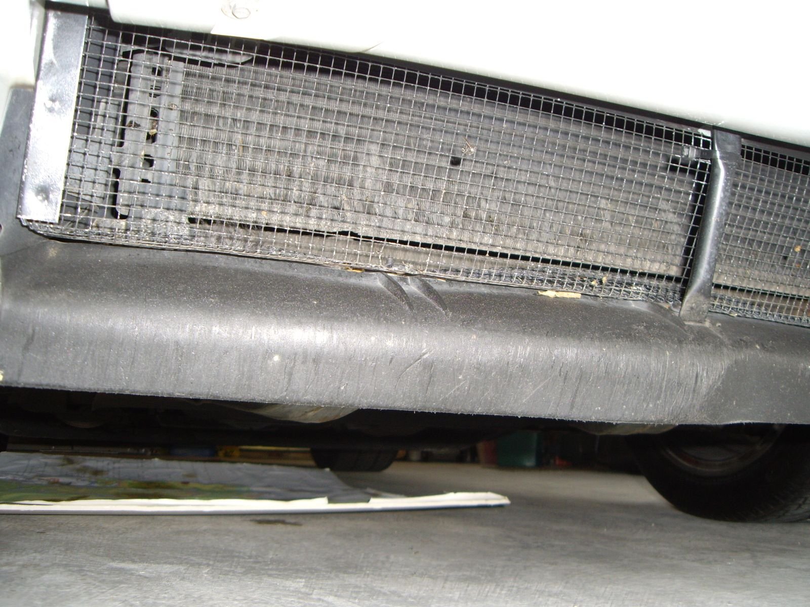

You can do yourselves a big favor by adding one of these while you're at it:
It won't stop everything, but it'll keep a lot of debris out of the cooling stack.
Live well,
SJW
what is that and where do I get one?
The po of my car did it, I like it. It looks like some screen/expanded metal from the hardware store that was cut to fit.
You'll have to make it yourself, but it's not difficult to do. Check out this old thread, which contains some info about it:
https://www.corvetteforum.com/forums...trategies.html
Live well,
SJW
Thanks, that is a good mod.
Here is my version........
Not hard to do.
