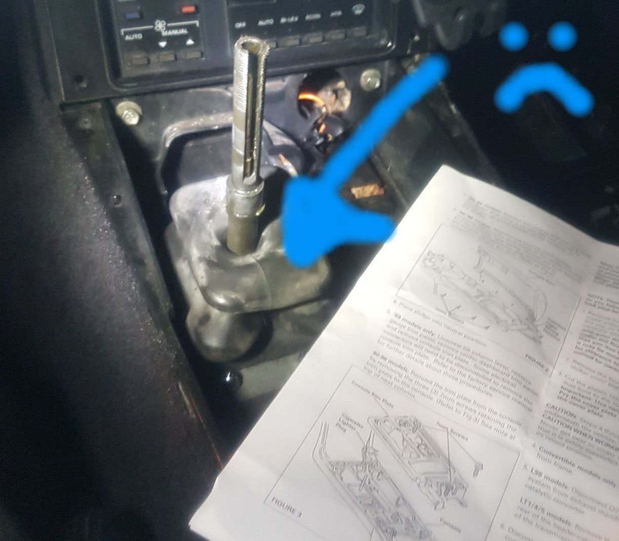

In the middle of installing the Hurst shifter.
I have removed the console, x-brace, exhaust.... but I can't remove the upper boot . I have removed the 4 - 11mm nuts, and the metal around the boot.
Need some help, so I can remove the boot - anyone ?

The bottom edge of the boot fits around a raised lip on the tunnel. Although the shape may hold it in place there is a really nasty sticky tar like glue that holds it on.
Just be careful and start at a point (like the right side rearmost corner because it is easy to get to) and pull it out and up. Once it starts coming loose, continue working it all the way around.
The driver's side is very close to the console edge so it is tough to get off or back on this edge. Just be patient and keep working at it. If you use something sharp like a screwdriver you may puncture or tear the boot. So be careful. I used some popsicle sticks that seemed to help some.
Good luck.

Thx'
Got it out :-)
Wow - This is the most fun I've had in a long time ! - lol
Boot, C-clip, Pin......
Now I just have to put it all together
