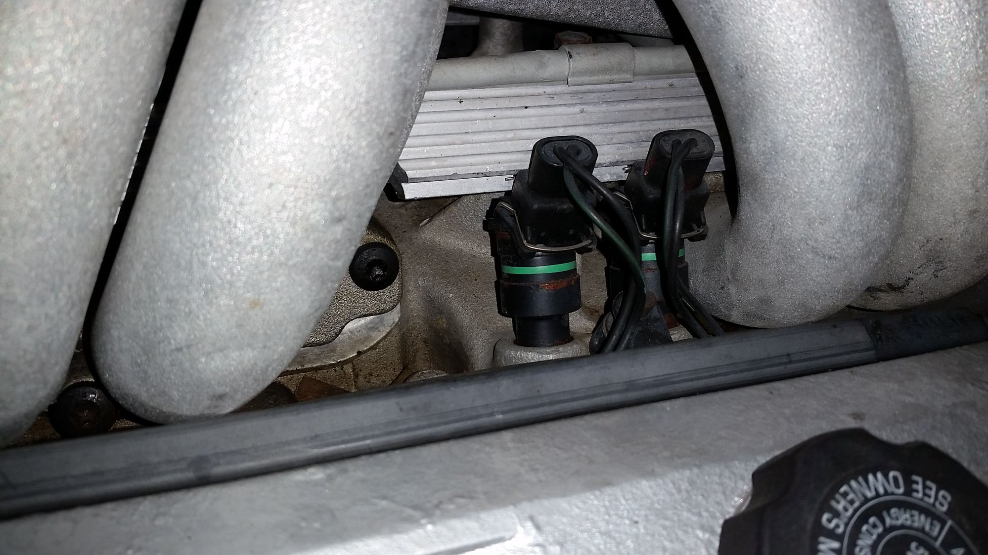

Are these Multec injectors?

no, they are not multecs. they look like bosch or a bosch design.

OK - I bought the car in January and was not sure. PO must have changed them at some point. The car runs pretty good so I did not think there was any problem with them.

well, from the pic, you have an aluminum head L98, question is, what year? i'm curious about the green band, and i'm thinkling it might indicate the flow rate. I have seen those green band injectors on a land rover. , one of the PO's changed them out. FWIW, iron head L98's usually had 24 pounders, aluminum head usually run 22 pound injectors. if your car is running decent, I wouldn't worry too much about it.

well, from the pic, you have an aluminum head L98, question is, what year? i'm curious about the green band. i'm thinkling it might indicate the flow rate. I have seen green band injectors like yours, that were on a land rover. , one of the PO's changed them out. FWIW, iron head L98's usually had 24 pounders, aluminum head usually run 22 pound injectors. if your car is running decent, I wouldn't worry too much about it.
It is an 88. I was just curious because they are kind of fat looking like the Multec's and I have read so many bad things about them.

Lucas injectors. Had them on my 88 also.

I have seen green band injectors on a land rover.
"lucas" - "land rover" -- that would explain the connection.
