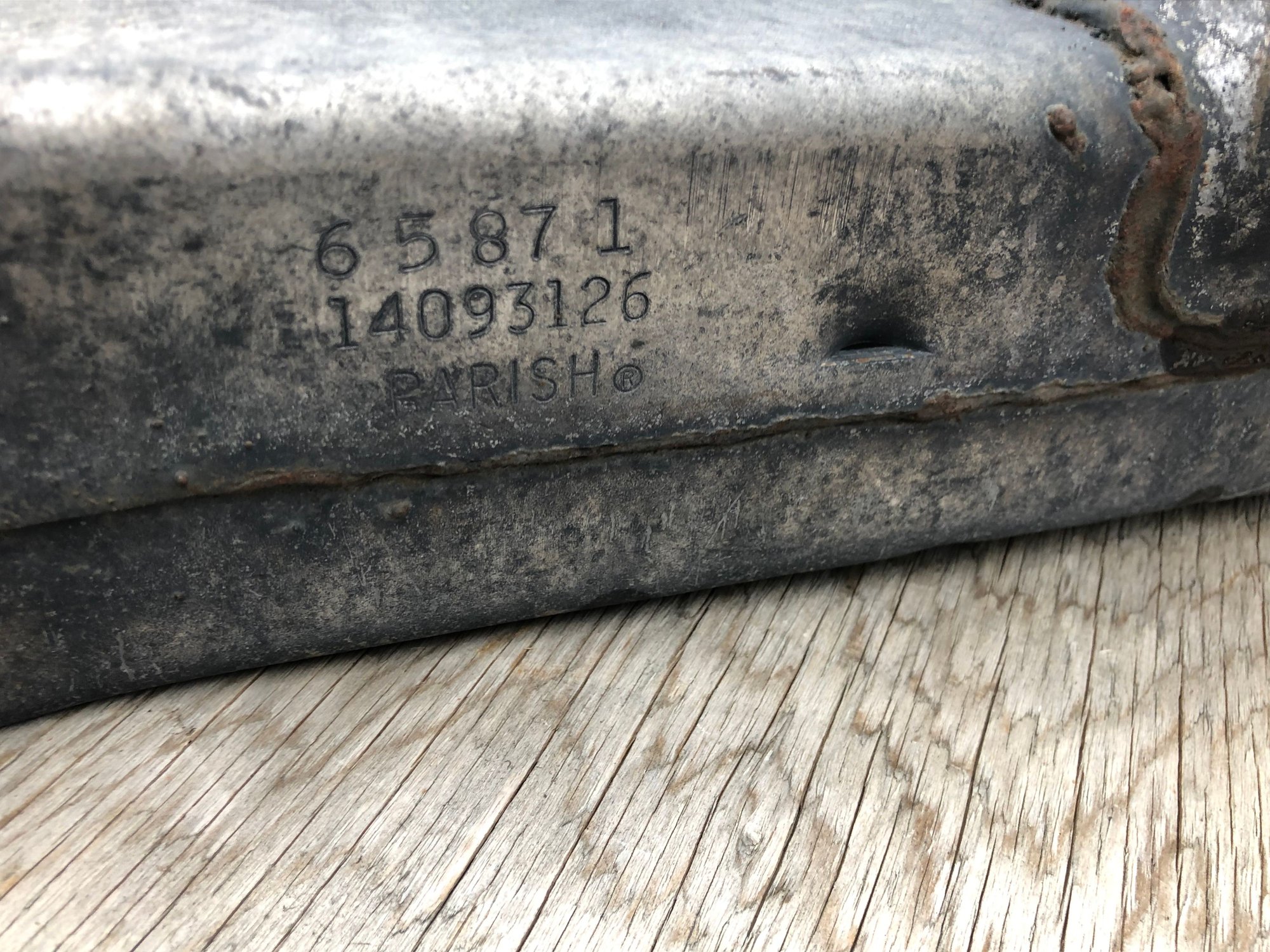

Originally Posted by ihatebarkingdogs
84-87 = P/N 14093126
88-91 = P/N 10080751
My fiche doesn't have a listing for 92-up. Kind of odd. I know those cars have the part. My fiche was issued Nov, 2001. both P/N's above were DISCON at the time.

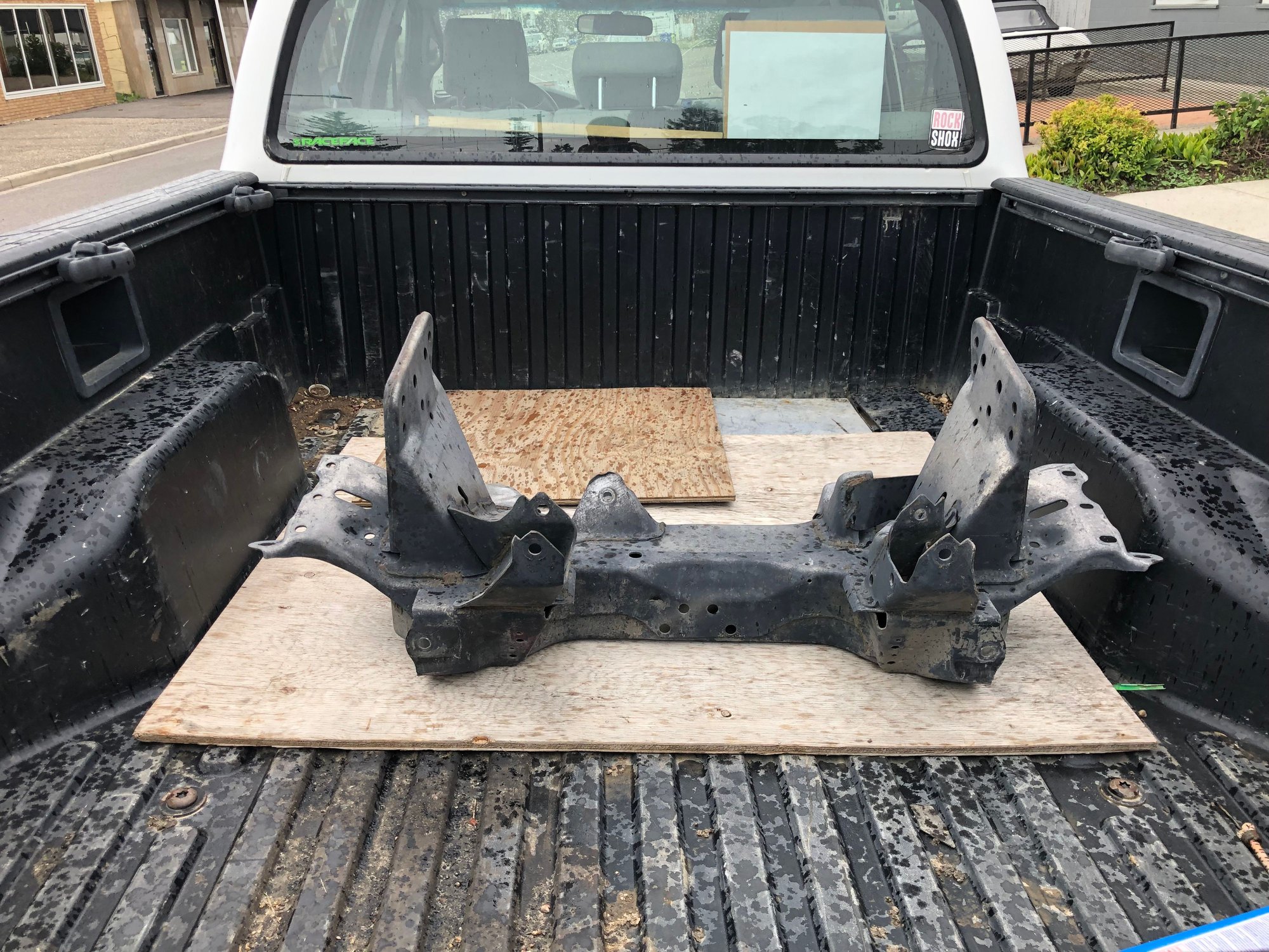

thanks. found an 86 for 250$ from my local boneyard up here in yyc.
hard to believe this 87 has been sitting lame for 2 years!
will be nice to get it fixed and out the door.

great! i dont suppose this was for the alberta car that drove over a pieice of steel c channel?
