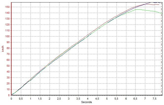

Summer 2015 I borrowed a VBOX performence meter, I think that it was this one:
https://www.vboxmotorsport.co.uk/ind...ers/vbox-sport
I made three runs with similar results. Seems close to your 3.75 seconds bogor.
60 mph = 96 km/h
100mph = 161 km/h
Air intake duct to turbo had some major restrictions that I removed during winter 2015-2016.
did this result in reduction of 60-100mph time with 0,7 seconds?
