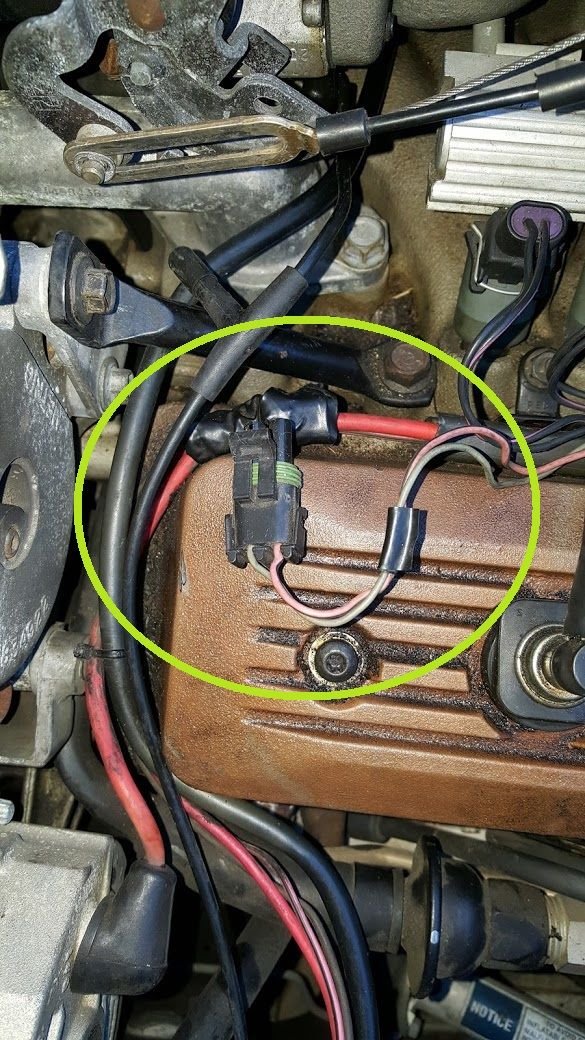

I discovered this loose plug on our 1990 C4 (drivers side). I don't see anything immediately obvious to plug it into. What is it?

EGR control solenoid that appears to be missing. Usually mounts under one of the bolts for the water neck.
