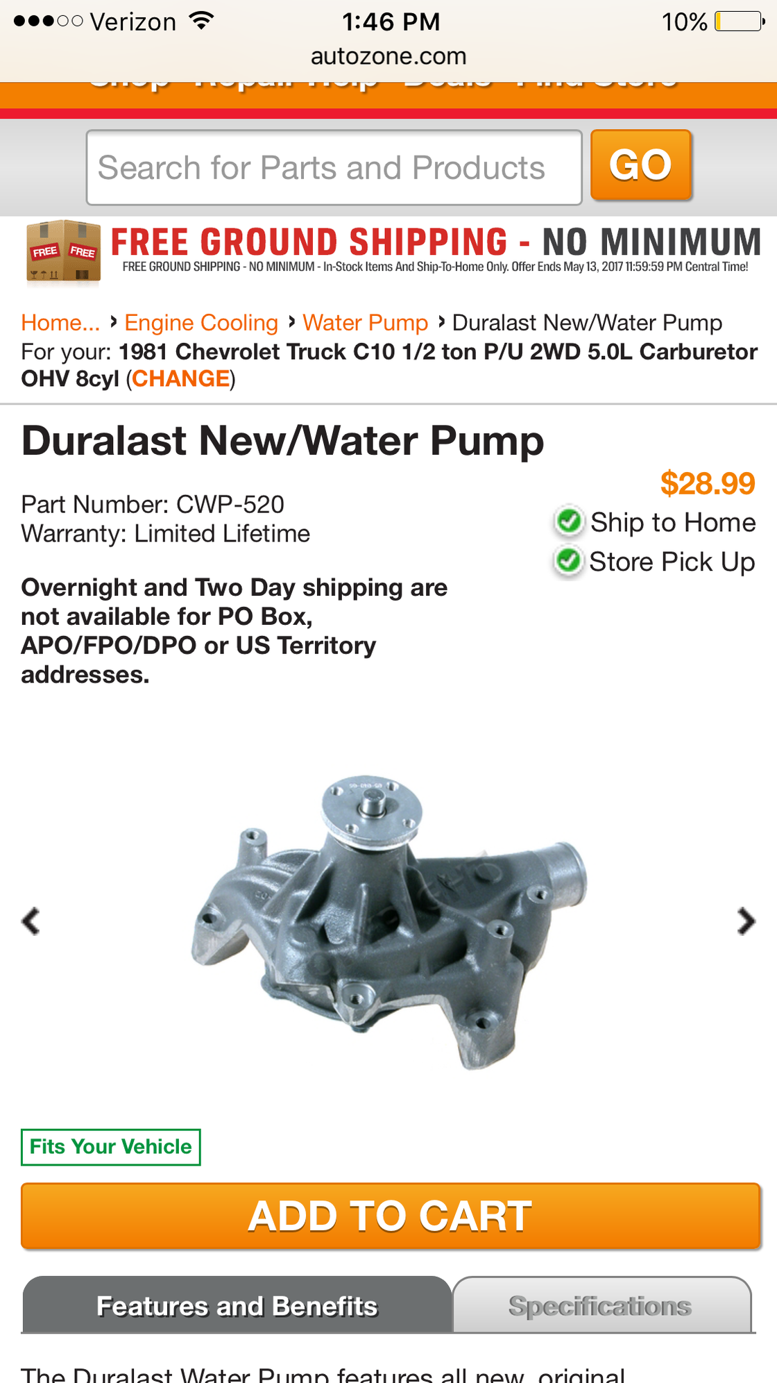

Upon further research this pump appears to match up perfectly

So how do I remove the belts to get the water pump out? I've never worked on a car with no tensioner...
Loosen alternator on pass side then loosen AC pump on driver side. Not difficult. I don't know witch pump but when you get it off bring to parts shop with any engine info you have.

Originally Posted by CES760
Last digit is 8
8th digit your VIN is likely an H - like this maybe but for sure 5th thru 8th should match 3GCCW80HXG............
Use the GM TRUCK VIN DECODER here
https://service.gm.com/dealerworld/v.../vincard86.pdf
Originally Posted by WVZR-1
In your particular situation I believe you buy "local" and match before walking out the door OR make sure there's no exchange issues.
Match the water pump to the 8th digit of your VIN.
What is that 8th digit?
engine is not original to vehicle, op said it was a previous swap before he got it
Old May 13, 2017 | 07:00 PM
WVZR-1's Avatar
WVZR-1
Joined: Sep 2003
Posts: 25,394
Likes: 2,741
That's exactly why I mentioned for him to use "the car" - the only thing that is an "add" is the TPI!! Accessory drive is original!!

Thanks to all of you guys the new water pump is in and I even replaced the IAC while I was there. The water pump was the second picture I posted. Thanks again for a the tips my car is running like Marshawn Lynch...
