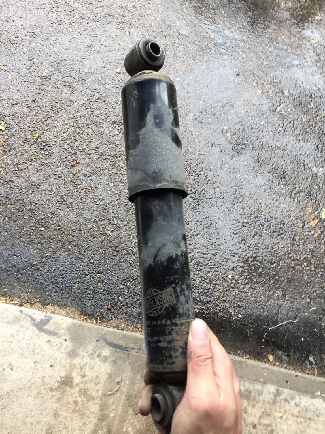

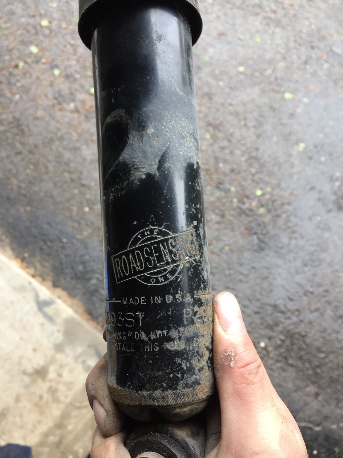

Is this the original shock? Just pulled it off my '84.
No - That's an old "TradeMark for TENNECO!!
Ok thanks. How old would you say they are? The one I pulled out is easy to push down but very slow to retract.
