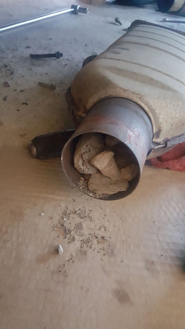

I went back under the car and tried to find the noise again. I heard something on the front of the main catalytic converter, nothing on the rear of it, and nothing at the rear of the pre-cats. So I dropped the exhaust (never realized 7 bolts would do it) and found this:
Knowing I live in an apartment complex with two apartments on the other side of the wall and ceiling to my garage, I went ahead and started the car up without the cat/mufflers on. She sounded much better and the knocking noise is gone. Tomorrow I'm going to pull the front pipe and knock the pre-cats out. After that I can take it for a spin and ensure everything is fine. If it is, I'll have to look at replacements, if not, I'll need to leave her be for another week or two while I move. I'd really like to drive it around though. :-)

looks like your cars,or any cars, way of having kidney stones... never saw that b4.
I have well done, I am surprised that you didn't fall rite on top of that in your first look's that had to make a Racket.
Now on a more Serious Note, Be Careful with that stuff it's full of Heavy Metals. So make sure NOT to Breath it or Suck up dust with Shop Vac. because that would really throw the dust around.

Yeah, I didn't hear anything my first go around and only barely heard it on the second attempt.
I dropped the front and knocked out the pre-cats. The passenger side is the one that broke apart, leaving only half of the material left in the pre-cat. I buttoned it all back up and started her up. It *seems* like it's running good, though there's a noticeable pop when letting off the throttle (in park at least). When it dries up outside I'm going to take it for a quick spin to see if there's a loss in performance still. Hopefully this has solved the problem and it'll be good to go.
Assuming that goes well, I should have a new front pipe and catalytic converter on Wednesday. If things don't go well, it'll have to wait until after the move...
