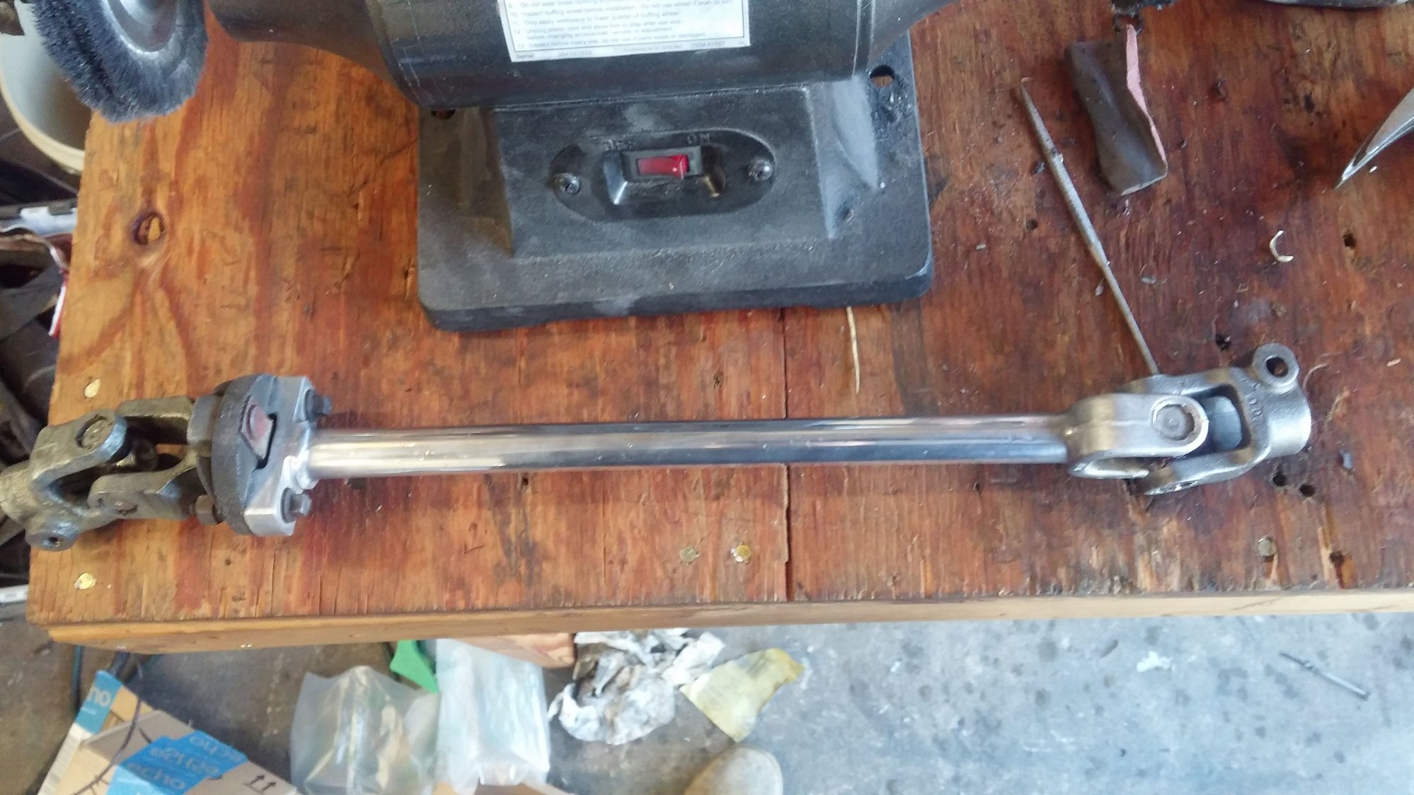

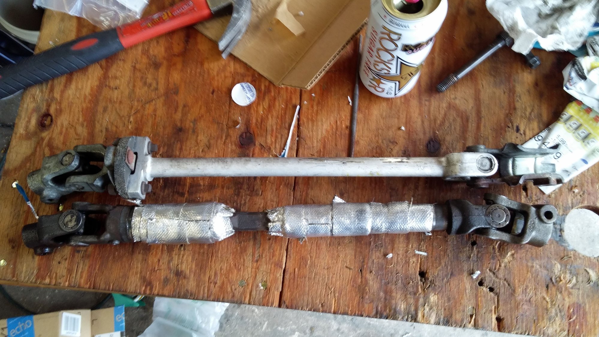

Good news, it worked!
I did have to swap out the steering wheel end if the intermediate shaft with the 84, however the ujoints are the same.
Here is a side by side of the two before modification.
Here is the modified shaft, i also gave it a quick polishing...
Installed...
Steering wheel lined up perfectly!
Only catch was getting the ujoints out, trial and error...
Luckly they are compatible with each other.
