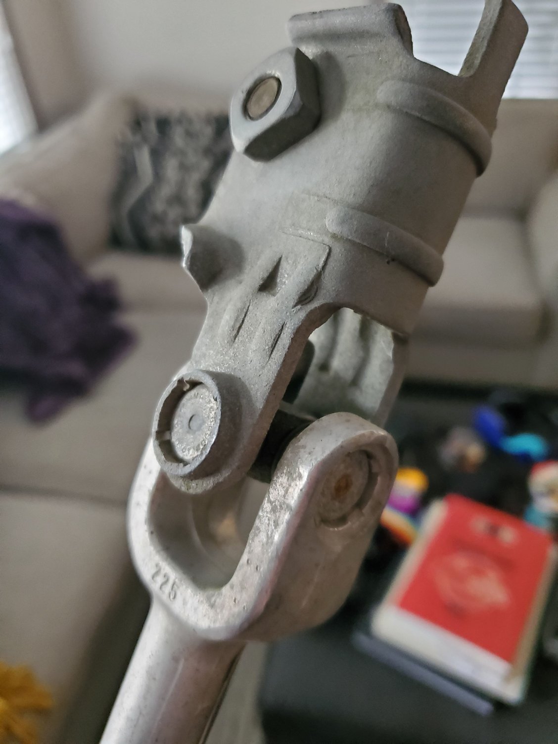

This is what the one on the 94 looks like. I haven't removed the old one to see what it looks like but OP had to swap this top portion to make it fit on his 85. I'm guessing I would just use a pinch to knock the pinned portions back and then drive it out with a press?
Thanks for the link btw that info was very helpful. Google was not pulling anything like that up for me

Just noticed the activity. Sorry. So if memory serves the late style will fit in to the rack no issue and does bolt to the steering column as well. What you'll find is the attachment point to the column is out 90 degrees if memory serves.
Edit: if you look closely at the first photo in post 8, you can see what I mean.
Nice! Thanks for the reply. I saw someone mention in another thread that you can just disassemble the rag joint to turn the top half 90 degrees so it'll line up. That's good to know!
