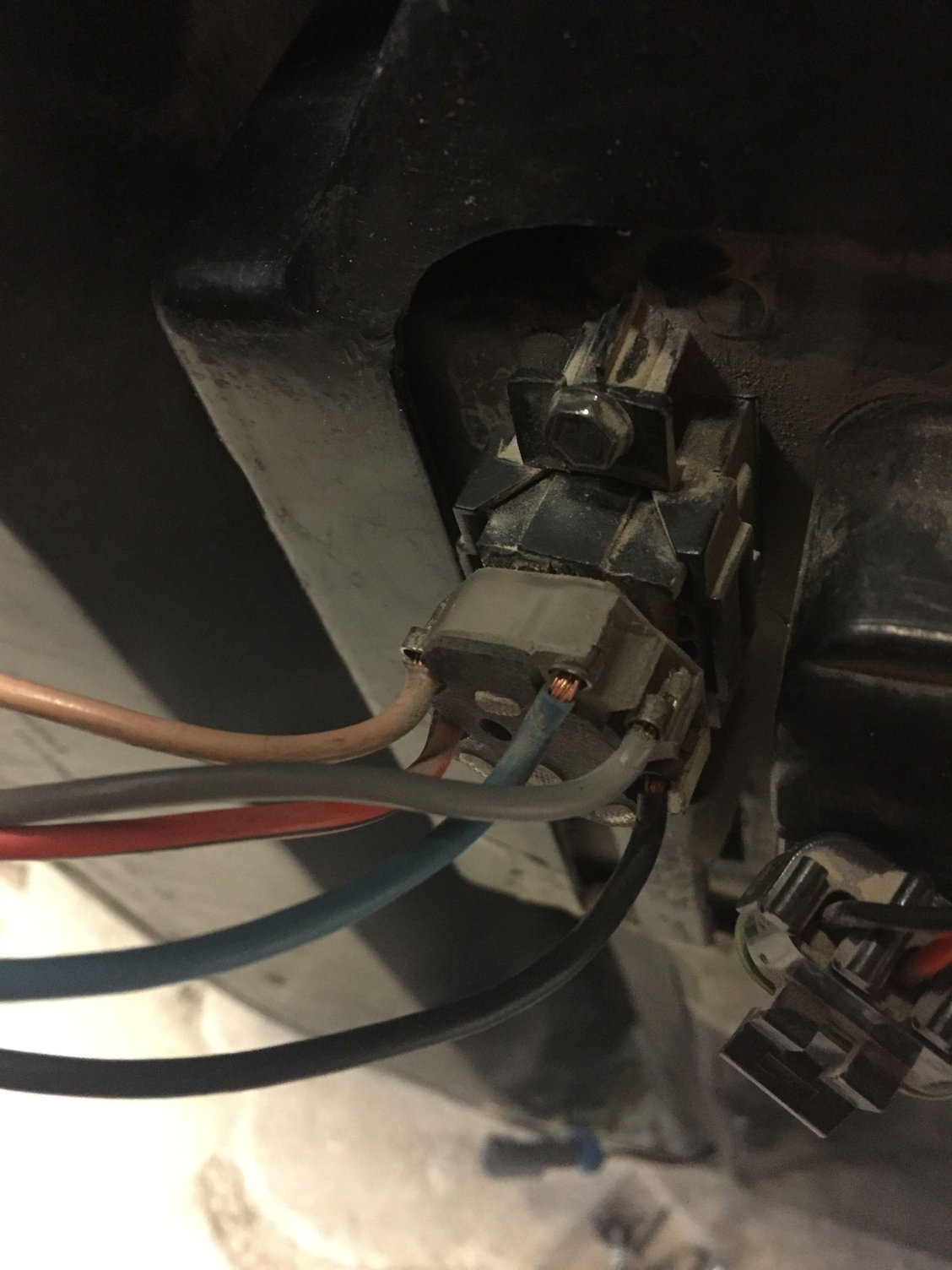

Opposite switch on door panel.

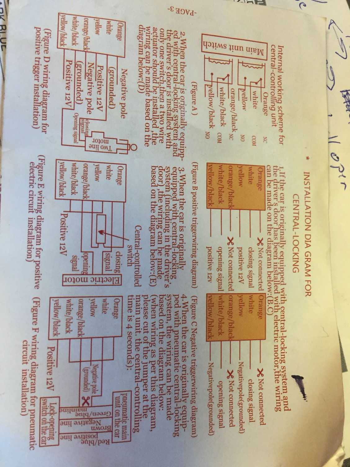

Instructions from module I bought
Diagram I found on web

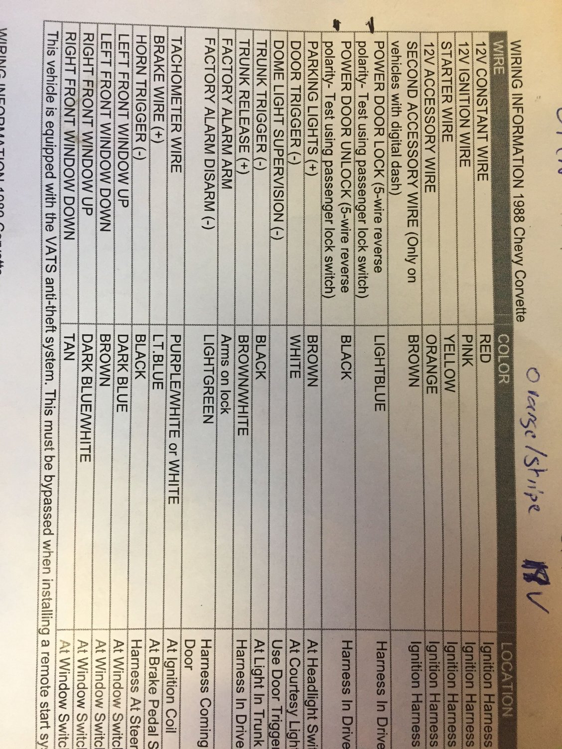

hey guys, I have a 1988, I bought a control box to have remote door looks . My question is how do I wire it to the vette. I've tried several ways but just doesn't seem to have enough power to through the locks open or closed.
I thought the unit had built in relays .
Its a 5 wire on these vettes right?
I see a blue, beige,black, orange/black and white wire on the switch of the car
orange / black seems to have volts all the time
i don't get it , isn't this just sending a 12 v to one of the wires going to open or close the lock?

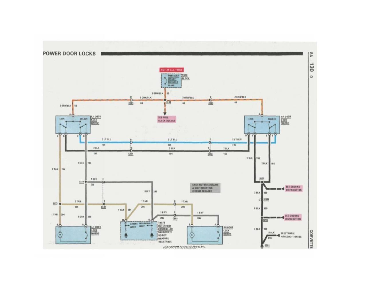

Could someone just post the wiring diagram for the door locks please.
Thx

This is from my 88 FSM. Hope this helps. If you figure it out let me know I was thinking of doing the same thing
88 Door Lock Wiring

I will try that tonight.
Thank you!

It worked!
thank you so much

That's crazy they had that many different wiring schemes.
i did get the power hatch switch working when I had the door panel off. But put it all together and didn't find the wire at kick panel. Another night I'm thinking.
Ive noticed if I use the key fob only it's fine and leaves the alarm alone.
But if I lock the doors using the switch , I have to use the key again to disarm the alarm. Otherwise alarm /horn goes off.
It's ok that way.
Thx again!
