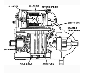

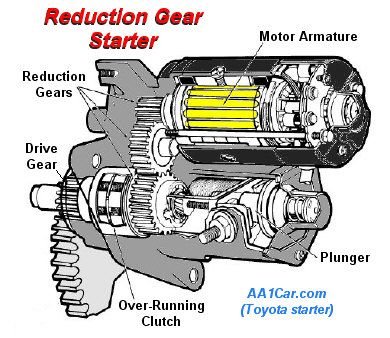

Stock 1984 starter has the motor in line with the drive gear.
With offset ger reduction you have the motor beside the drive gear and a reduction gear between them. This type uses a smaller lighter motor with more rpm. Typically all aftermerket ministarters are this type.
