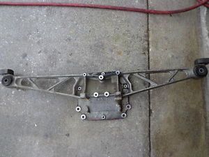

Originally Posted by WVZR-1
An '84 is the "weakest" of all D36 builds.
In what ways are the 84 D36 differnet from the 85 D36?
Mine had a stronger batwing than any other I have seen.
This is my 84 D36 with thich W on each side:
This is what they usually look like with one thin V on each side.

Originally Posted by JoBy
In what ways are the 84 D36 different from the 85 D36?
The actual differential carrier/case and it's internal side gears, pinions, shaft and also the short axles are different. Some '84 later production might have the better components but without disassembly you can't tell. The casting number on the actual carrier I believe can be used as an identifier.
I believe that even in '85 the '84 internals were no longer sold. You either bought an assembly or the pieces to assemble.

After breaking the pinion gear I replaced my D36 with a D44. I still have my original half shafts and no problems with them at +700 whp.
The second picture is not mine.
