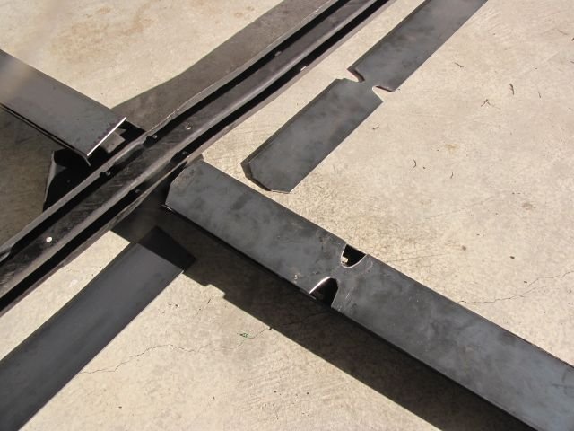

Since it's off, and if you have access to a welder, consider boxing the X-brace. You'll be amazed at the difference it makes.
Old Jun 6, 2017 | 09:47 AM
daustin's Avatar
daustin
Joined: Jul 2006
Posts: 94
Likes: 5
From: Woodstock GA
I hadn't thought of doing that, good idea!

Sometimes we needed spacers under the 'X' and we sold a few of our 'X' above ground X.
To 91 Convertible X brace
