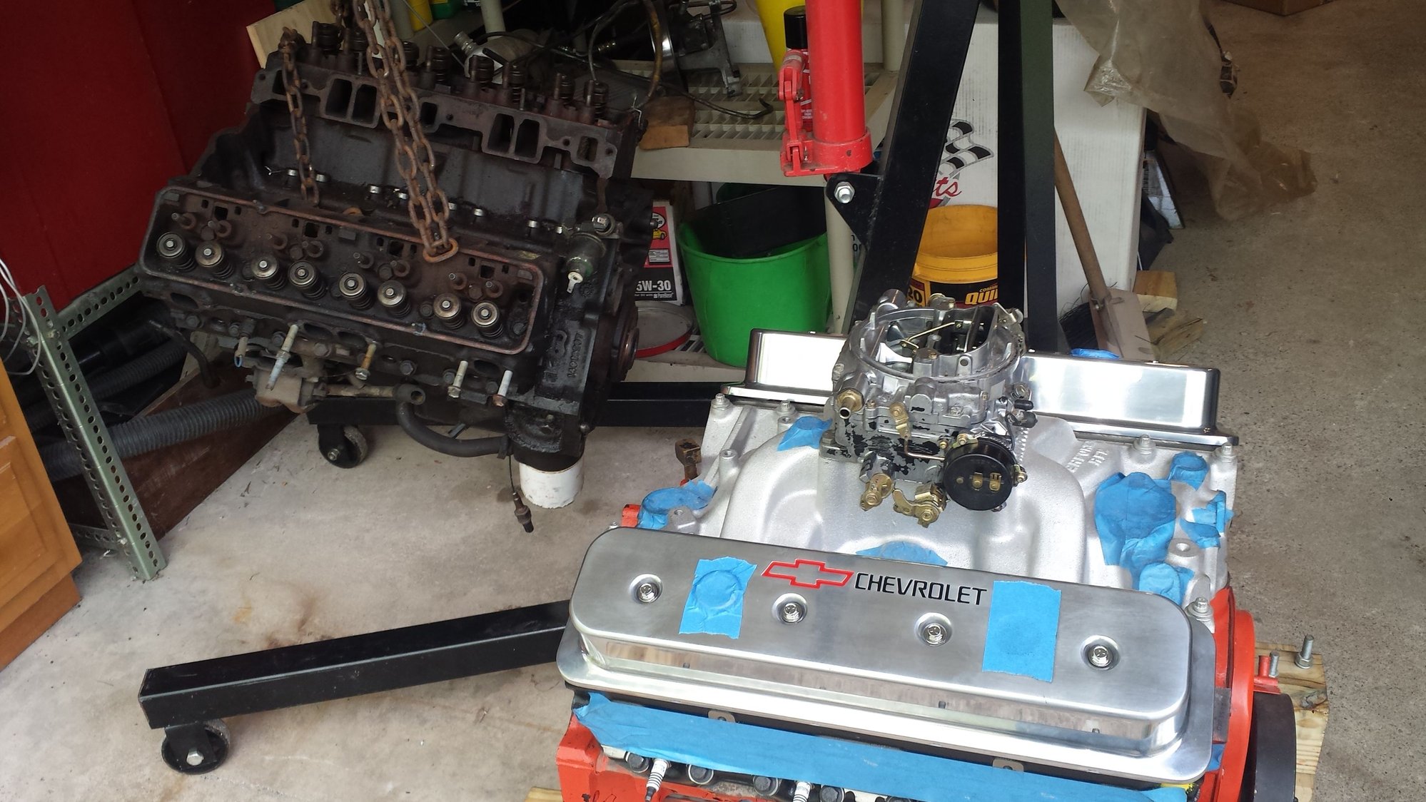

Hello Everyone,
Within the next few days I'm beginning to install my new 350. The pictures show a edelbrock manifold and carb. That setup is removed and I have a Scoggin Dickey tpi manifold with the original TPI runners and plenum. I have a BBK 58 mm throttle body. All new Internals and roller rockers. With Cast Iron Vortec Heads. Running a 2 1/2 inch Melrose Exhaust into Borla Mufflers. I'm expecting approx 330 hp out of the engine.
What should i expect the engine to run like with the stock chip? Is there someone where I could get the chip programed to my specific specs of the engine.
THanks
