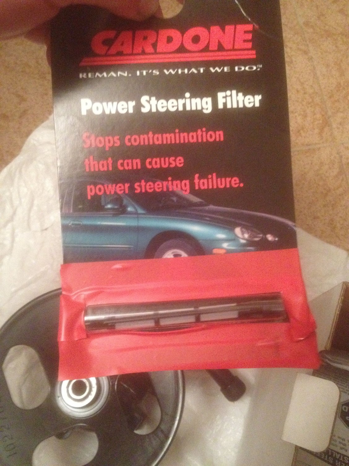

Pump is a cardone reman, is it a good choice?
And also i need to know if that in-line filter installation would be reccomended since i've already have a magnetic magnapure filter on return line??
However, there was copper flecks in fluid that was coming out of the pump
