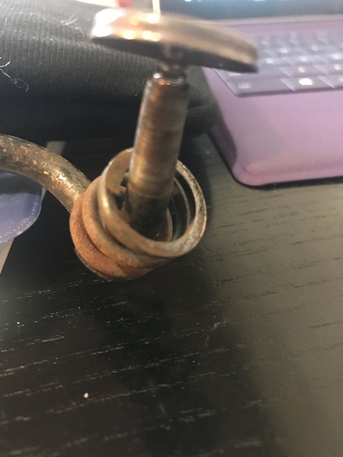

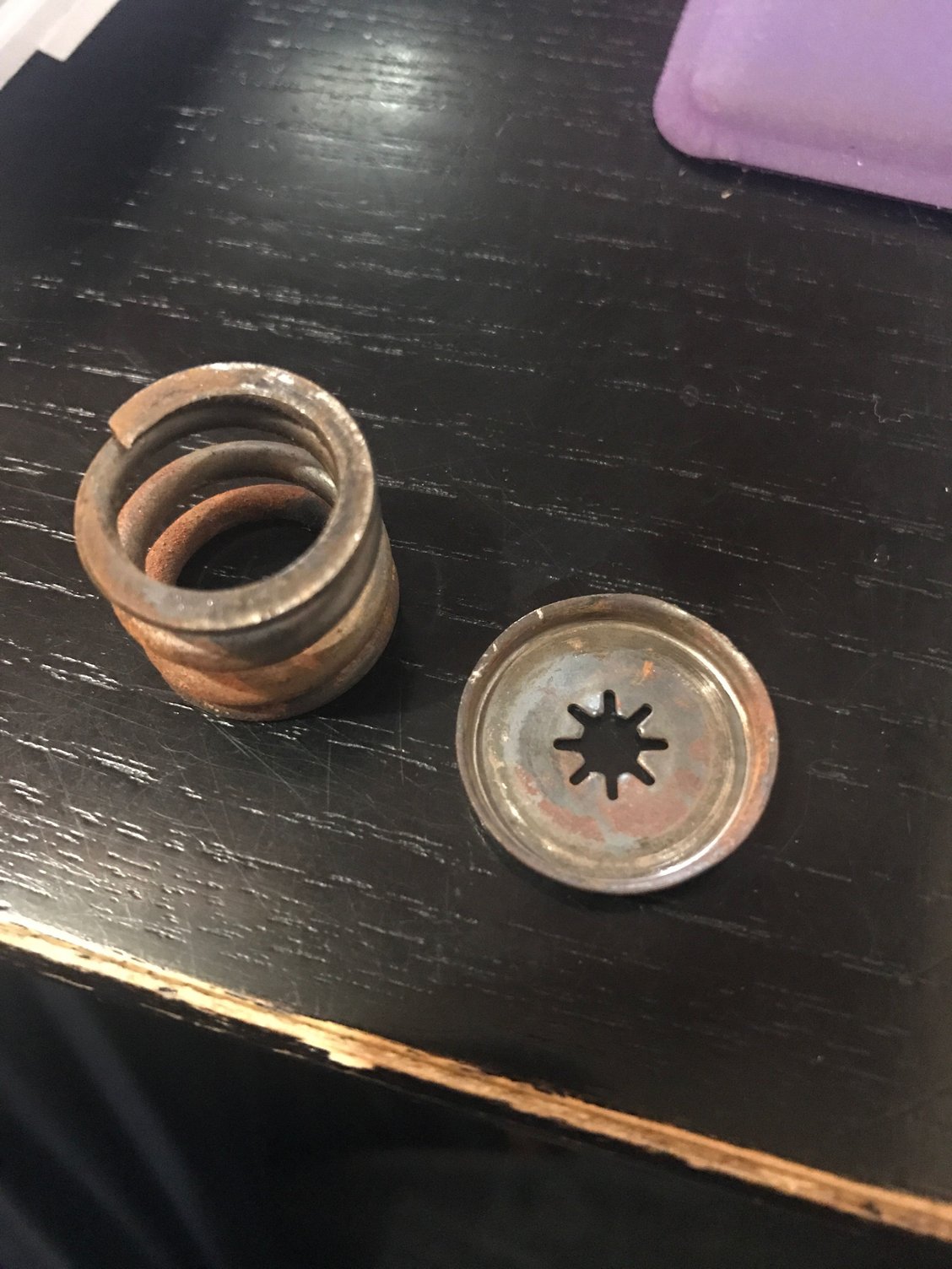

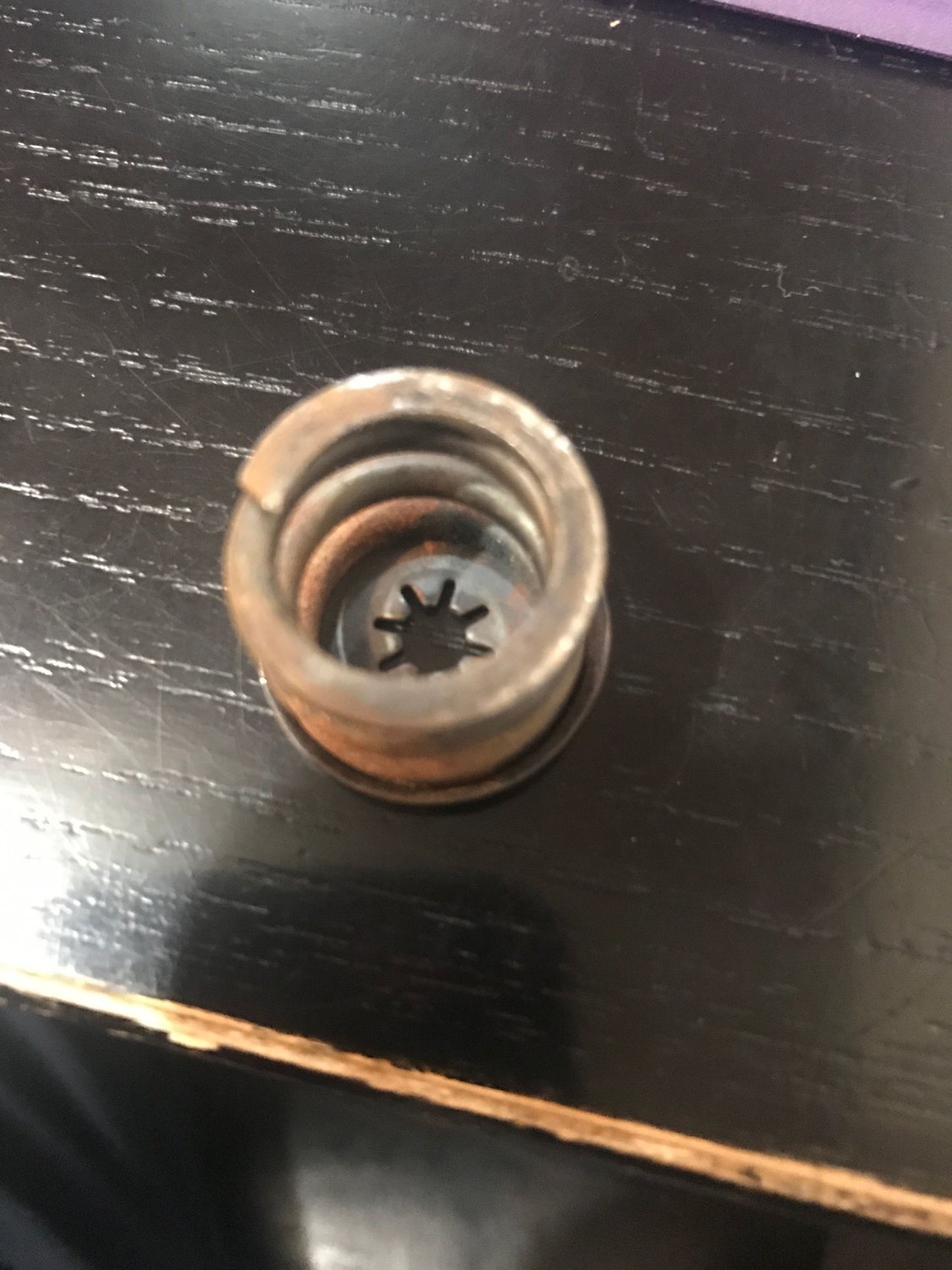

Hi Cliff,
thnx. here is my setup.
it appears that the large diameter retainer "washer" is built in to the "push nut" fastner on mine.
i will clean up the rust on these parts before install.

interesting, two different responses. I suspect that the early c4's from the factory they were actually push pins. ( I believe Cliff has an 86, and that is the year I am working on as well. )
Maybe they changed later on in the years?
i did have an 85 that had a nut force threadded onto it.
