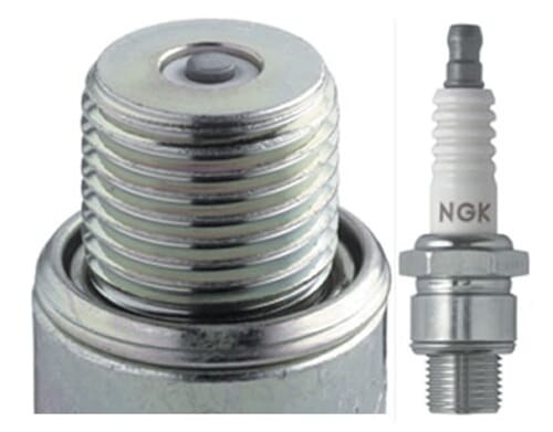

Originally Posted by Gibbles
One plug idea i like is in my boat, OEM mercury plugs are NGK with no ground electrodes, instead it grounds to the body of the plug, has a fixed gap that way.
Very resistant to fouling from the 2stroke, also super easy to clean!
The "perma-gap" plug. I totally agree....and would add that the spark is totally exposed to the combustion chamber/charge. To me, it seems like a perfect design.
