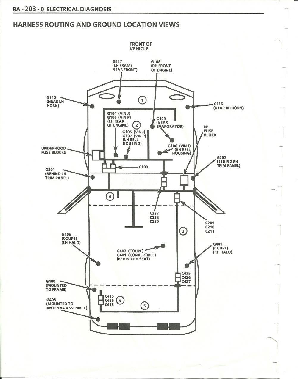

I'm not sure why some where leading you down the voltage regulator route without some basic questions.
1) Yes, check all ground points. I was having similar trouble in my 96 and I think the issue was 2-fold. Bad negative post screw on the battery not make strong contact and cleaned up the ground by the battery.
2) Any chance you have an after market radio? Can't tell you how many times improper installation of after market electronics messes up a car's electrical systems.
Your voltage level on the dash is well within spec, I don't see a regulator as being the issue.
Came across this pict which I believe is ground points on an 85.

thanks - great diagram - honestly I did not watch the volts on the dash that close until they had mentioned the alternator - The radio is from what I can tell original - am/fm cassette - I will be checking and cleaning grounds before moving forward on anything else - this might be a dumb question but - should any dialectic grease be used on grounds after they are cleaned - or does that undo the very thing I am trying to do?
