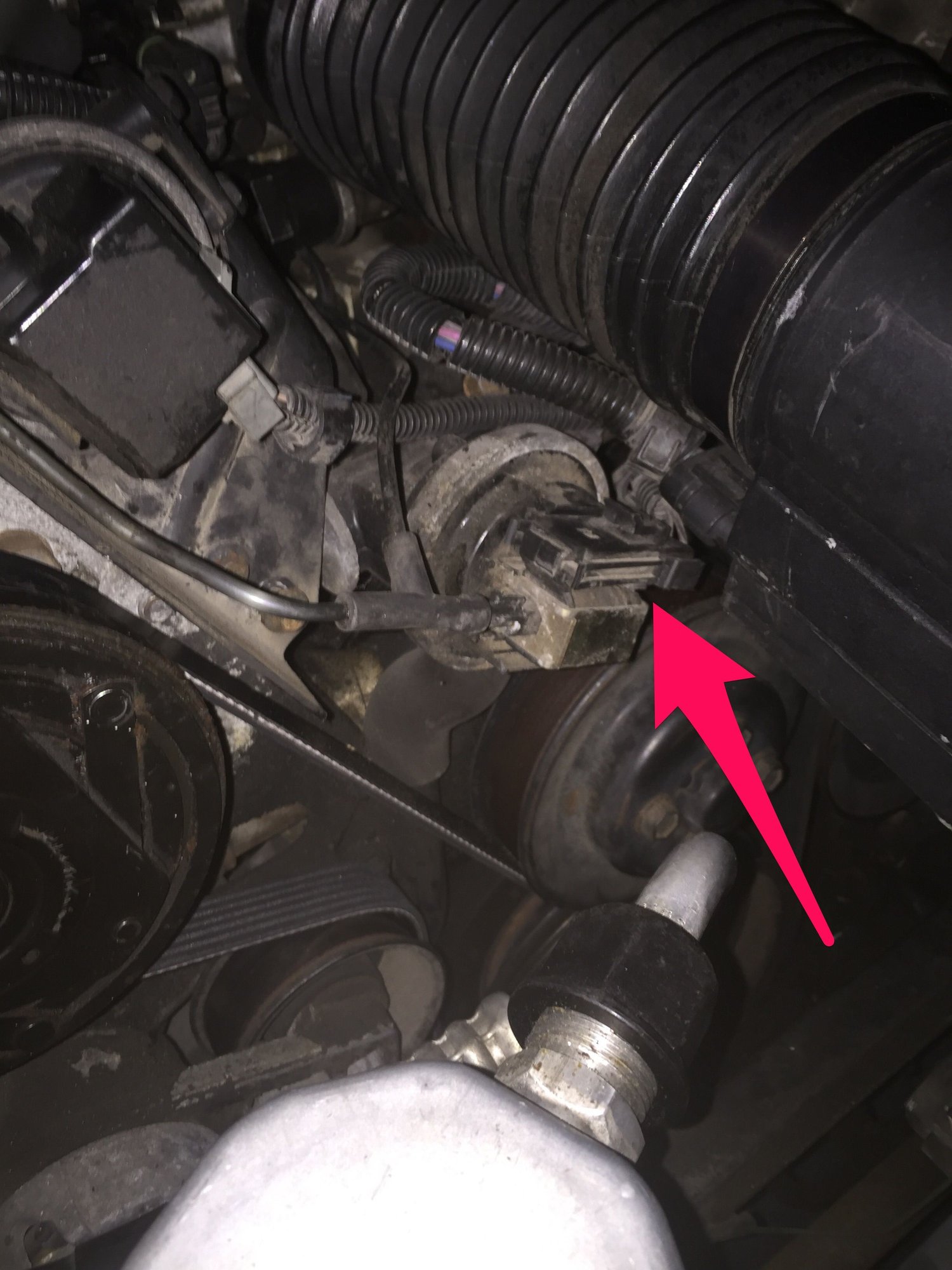

I was relieving tension on belt and accidentally broke a part near the MAF sensor. I don't know what it is. Appears to be a sensor? Had small hoses attached to it. Can someone help? Thanks!!

That's the A.I.R. diverter valve. The solenoid for that valve snaps on, so you might have dislodged it. You should be able to snap it back in place.
It looks like just the cover is missing. Check the other valve to see how it attaches.
