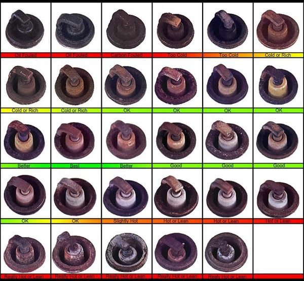

are you idling high? Where is your idle RPM at? You might take a look at your spark plugs. In a recent thread someone posted a nice graphic that I'll add to this post, showing what spark plugs are telling you. You may have already checked these things, I'm assuming nothing.
A video might help people here diagnose the issue with you. Think you could take a 30-second clip?
